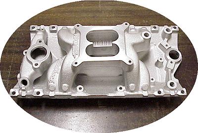

Ive just lost my vaction to this damn thing and am losing what little hair and patience I have. WHY WOULD THIS THING STILL LEAK if I checked for straightness,used new intake,gaskets and correct torque and sequence. Im temped to put a heavy coat of hi-temp rtv silicone down the length of the intake and try this...At least to find out if my problem lies here or here and somewhere else......THOUGHT ANYONE??????PLEASE PLEASE PLEASE
Here is the manifold in question...Note the open area between the front and rear sets on bolt holes...

I called Edelbrock and they said 4-1/2 pounds was ok.....Especially at the rpm range my problem is happening at. I still want to know what everyone thinks about running the rtv silicone down between the head and manifold....I figure at the very least I can take care of the leakage there and hopefully know that the leak is my problem. If not then it's one less thing to worry about right?

Paradigm shift-The motor ran GREAT for the first 40 or so hours...Then suddenly I got the miss and lean condition. I Havent' really had someone answer this but WHAT IS HAPPENING when I spray the starting fluid on the intake gasket "alley" between the heads and the gasket? When I do this I get a stumble accompined with a healthy drop in rpm's....What is causing the change in rpm's??? and if it is a leak then woudn't that explain my sudden condition and it's symptoms???? SOMEONE has to be bored enough to sit down and help me trouble shoot this thing out.....PLEASE (God and I really really hate begging

I would agree it sure sounds like you have a vacuum leak. I would think it is odd that ALL the plugs would be white if manifold is just leaking on the ends. I would not recommend the silicone but I guess you could try it as a trouble shooting aid. You would have to make sure everything is very clean or it will not work. Do you use something like permatex #2 around intake ports on your gaskets. If heads or block have been surfaced make sure you get an even crush on gaskets from top to bottom. I have to use the extra thick gaskets on one motor I built or it causes me trouble. Usually around water ports though.

Heads and block have not been surfaced....The instructions called for no sealeant on the gaskets as they ar a hard rubber/plastic with a silicone type crush instert around each intake port and water port. The only silicone now on the manifold is on the ends where it is to be used in place of the old cork pieces.....The leak seems to be coming from both sides more towards the center on the sides where there is no bolts... see the pic below. Whould using two gaskets be an option?
