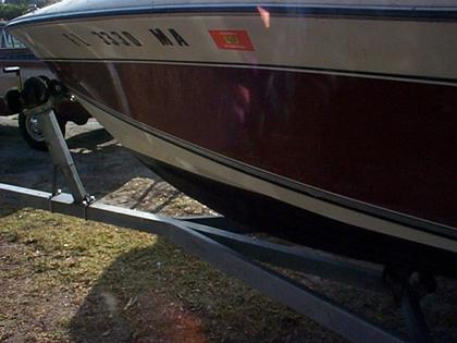

This hull should be very similar to yours. It's and 81 F20SC. This is with the bottom paint.
