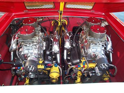

Here`s what I`m running through TRS drives. I`m satisfied with them.

Got to see it at Too Olds last spring, she`s a real clean rig.Here`s what I`m running through TRS drives. I`m satisfied with them.

That is a sweet looking setup you've got. Wow!
