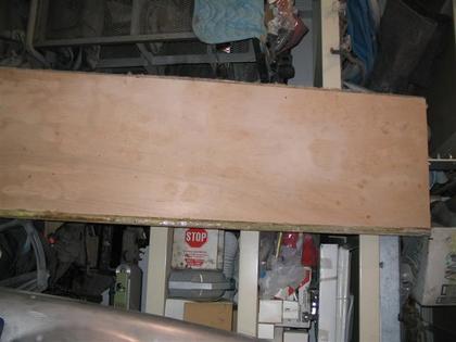

The old floor was made up of what looked like sections of wood that they had laying around the shop. They were made up of 4 pieces of plywood. I decided to make them out of one piece.
Attached Thumbnails Stringer Replacement Formula 302-66-core-bonded-down-small-.jpg
