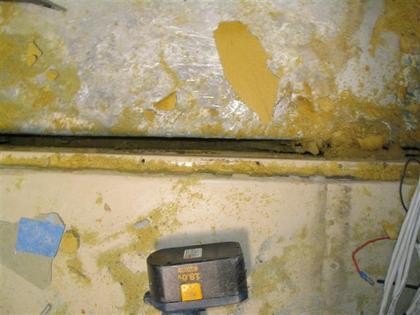

Then the fun began. At the advice of a friend that build boats I stopped over to his place and he gave me this electric chain saw to go to town with
Put your best foot forward!
Audiofn is offline
Old 01-04-2004 | 12:26 AM
Audiofn's Avatar
Charter Member #232
Posts: 18,417
From: Carlisle, MA USA
The chainsaw was great at taking out the foam btwn the tank and the stringer. It was amazing that it did not even touch the glass on the stringers or the tank. Very efficient way to take out all the foam.
