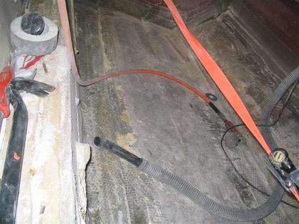

Since the first stringer took me 8 or 9 hours to grind out I had to go to plan B. I got this planer from my friend as my crappy one was to whimpy and my good one is super expensive. It does the trick. Turned that 8-9 hours into about 3. You have to be real carefull and watch as you cut through each layer of glass and know were to stop. Now we are moving ahead the way I figured we should. I can not tell ya how many bags of trash I have removed and how many times I have filled up the vacume cleaner!!!

Old 02-22-2004 | 07:34 PM
  #102
Audiofn's Avatar
Charter Member #232
Posts: 18,417
From: Carlisle, MA USA
another
Attached Thumbnails Stringer Replacement Formula 302-51-second-stringer-sanded-small-.jpg

Old 02-22-2004 | 07:36 PM
  #103
Audiofn's Avatar
Charter Member #232
Posts: 18,417
And we are finished and ready for the new stringer. On this side I decided that I would start to pull the bulkhead in over some time so I put the ratchet strap on there and pulled it in.
Attached Thumbnails Stringer Replacement Formula 302-52-second-stringer-sanded-small-.jpg

Dude, I'm thinking that you are going to wish you had sealed off that cabin entrance! Just looking at that poor shop vac, I can only imagine what everything else including you looks like. What a great job! I'm hiring you if I ever need major boat surgery. Keep up the good work!!
