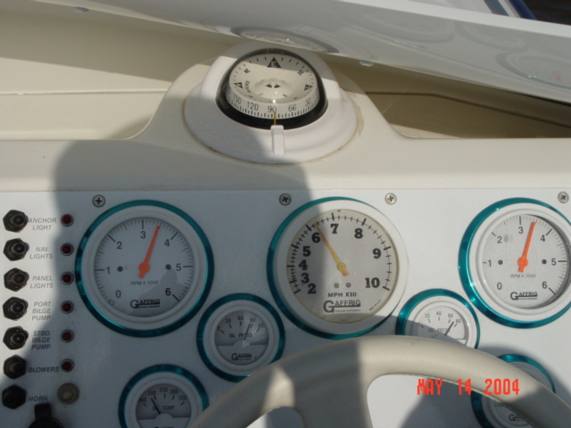

Drives are 1.5 I believe

mcollistn,my idea is he only has 3 mph difference between the 2 props at same rpm,it should be more like 5-6 mph unless there ratio is a little closer than 2 true pitches,his boat would run high 90's w/a 29 pitch at 5000 and he probably doesn't have that much motor,so is it dying off at 4300 or is it going about as fast at that rpm/prop and gearing as it is going to go at the amount of power he has at 4300? He DOESN"T have 1.50 ratio drives (he would be at 73 mph at 0 slip with his 27 pitch at 4300) so if his motors make 625 hp at 5200 but make 500 at 4300 i would think he is trying to pull too much gear and prop for the speed of his hull. I'm not convinced he has anything wrong with his motors.J,if you trim it to the max do your rp'ms hang at 4300 or doe's it rev higher?Let us know what you find,Smitty

I can get more rpms if I really over trim it. It just wont pull more rpms under load. Im out of town until Thurs., but Im going to take it out out Thurs and have someone look at the plugs. I also found some 25p hydros that I can borrow. Thanks for the suggestions.
