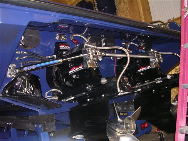

The exhaust is as high as I can go underneath the platform. Anything higher has to go over the platform.
