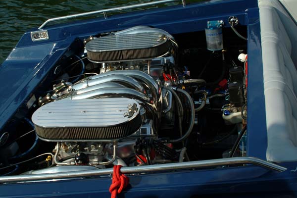

Exhaust exitsunder the swim platform, there is a recess underneath near the transom, Pipes used to come out 6 inches but I had them shortened to only 1.5 inches past the transom. The boat sits very low in the water. the platform is right at water level. two pics to show how the exhaust is routed.
The pipes are not in the water but they stir things up when idling.
