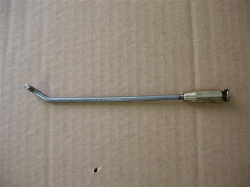

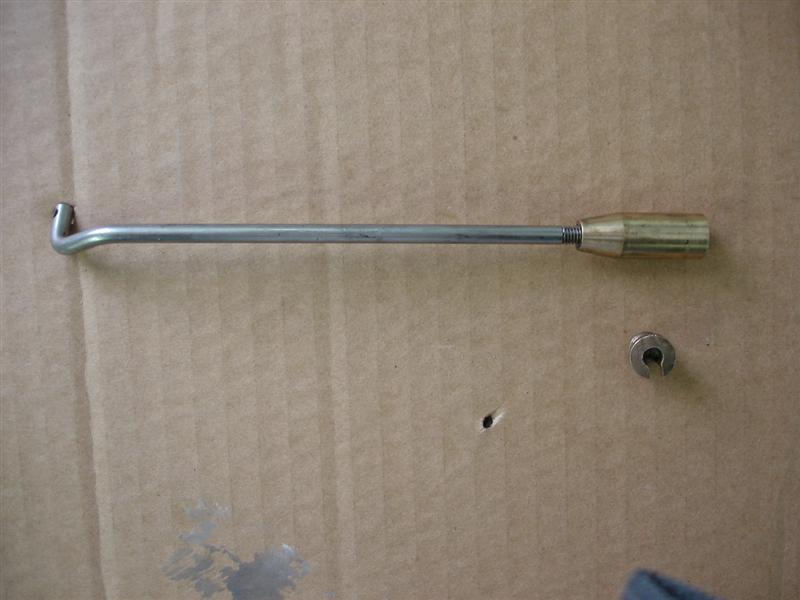

The arm that connects to the fork arm has a little bend to it , also the piece that attaches to the cable has a little ajustment there, not much.it also has loc tite on it and can twist the arm/rods if your not careful.
....................1
also dont grab the brass threaded sleave hard with plyers it will bend, close up and you will not get the cable end in the end of it .Had a repaired drive came back to me that way.Friday night trying to go to a poker run, had to hone out the thread tops
to beable to get the cable end into the brass sleave .wasn't much thread left but it held and I ordered a spare that monday
Hope this helps
Rob
Hope this helps
Rob
