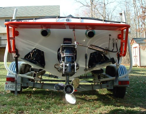

I will probably bite the bullet and buy a full system. That leads to another question. I don't care for the way my ram is currently mounted outside of my k-plane. It might be a tight fit going inside the k-plane though. What is the minimum distance from the gimbal needed? Looking at IMCO's website I think the shortest system they have is 9.75", which I don't think I have.
