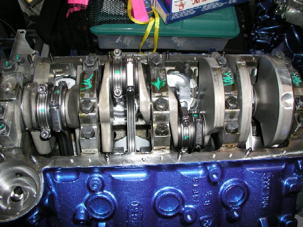

Originally Posted by dyno
Chris is that a short block from Dyno flow?
Yes it is. I was surprised, no extra "hidden" costs, the price they quoted is the price out the door.
Panic Button is offline
Old 11-08-2004 | 08:52 AM
dyno's Avatar
Charter Member #655
Joined: Dec 2000
Posts: 4,939
From: Holland, Michigan
Default Re: Engin Balancing Question?
so what did you buy? I've been looking at there stuff for a couple of years but was waiting for someone else to take the plunge....guess your it!Lets here about your combination heads,intake...????are you going to dyno it?did you check any of the clearances? I think I'd have to grab some plastigage and check a few before I threw the pan on.
