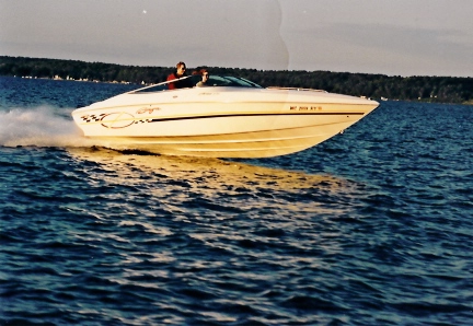

kenny,are you using a nose cone? On my 272 i'm turning a 30 pitch 4 blade labbed prop around 5400,this summer while i was waiting for parts for my outdrive i bought a spare drive w/out nose cone and the boat felt like the nose was digging in,boat was hard to get trimmed out enough to loosen hull up. My hulls a 2000,ive had more problems with chinewalking above 70 than anything,full hyd strng helped take most of that out. Do you have a pic of your boat at speed,it really needs to be on hull pad towards back to air out enough to get good speed. I'll try to post pic if i can find one,Smitty

Default Re: Hull problem???
That pic is at about 80mph without a nose cone,everyone i boat with says when i'm going mid 80's i only have about 2 feet of hull in water and that it almost looks like just the drives in the water. I haven't done anything to rear edge of hull yet,everyone says these bajas will go 2-3 mph faster without it BUT that it greatly increases porposing unless your dragging your trim tabs,Smitty

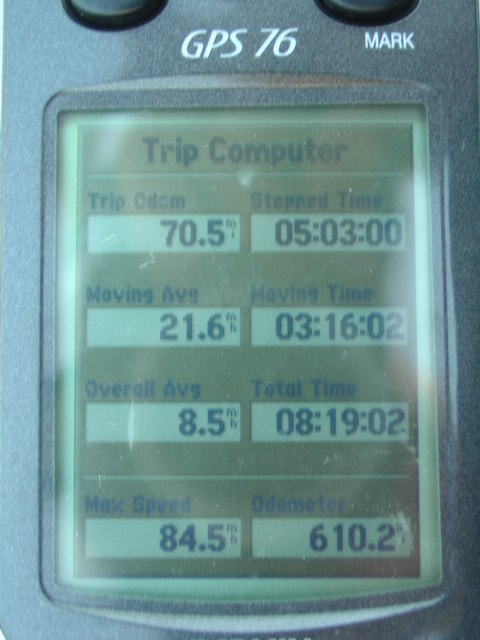

2000 baja 272,540 motor with m-3 procharger,30 pitch lab prop,85.1 mph gps best ever w/boat empty,83.5 mph any day of the week with 3/4 tk gas and 4 people,84.5 w/just me and the ol lady 1/2 tank gas and cooler full of BEER . Boat went 78 mph w/502 w/procharger & lightning headers turning 28 pitch 4 blade around 5200. Boat went 62 mph bone stock w/4 people,3/4 tk gas,23 pitch at 5050,Smitty
