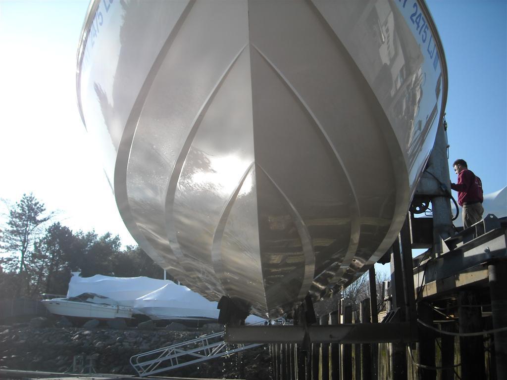

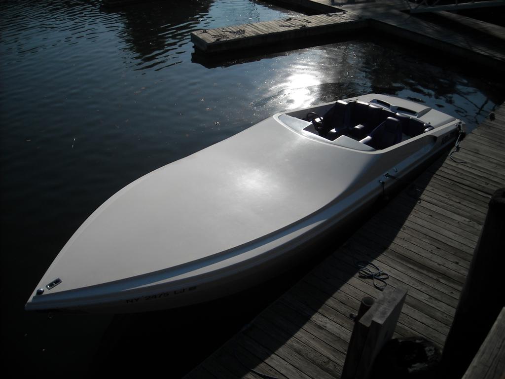

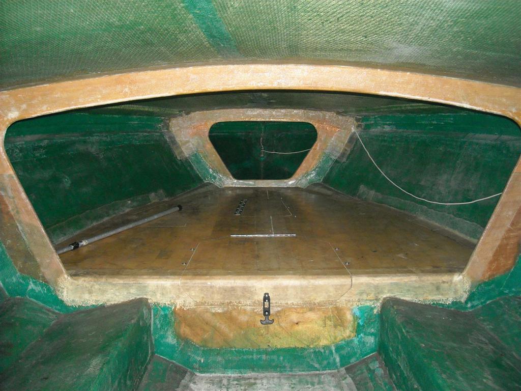

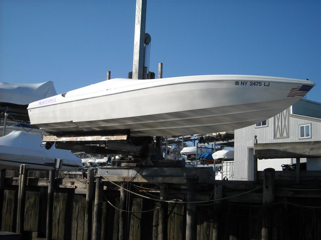

So it's a 2001 27 Kryptonite. It has some very nice and smart features I liked when I was shopping for a new ride. The previous owner (Holden) had it built without the pad (it has a V where the pad would usally be) and a notched transom. The boat is very solid. Cored hull and sides vacumed bagged with vinyl ester resin. Hull and deck glassed together. The back seat lifts up with the engine hatch and the bulkhead is cutdown so you have easy access to the motor, plus the 8' beam also helps. The cockpit is a full liner cockpit with drain holes in the corners to the bilge. Under the back seat you will find the gas tank fully glassed in with a drain hole just above it to the bilge. While everything from the cockpit back drains into the bilge there is no drain hole in the bilge for the water/oil/fluid to flow back through the entire hull. Everything stays contained in the bilge with just a drain hole at the transom. So basically if you get some water in the cuddy you have to dry it up manually, gravity won't help you. Which also means gravity won't hurt you because all the schit can't flow from your bilge into the cuddy. I like this alot.
Holden has already rigged it very nicely so I don't have much to do there. Just a few things once I drop my motor in. Most of my work will be in the cuddy. I'll probably just gel/paint it and get some cushions made up for the facing benches. Which I can lay down on at 6'. Maybe some carpet in the v berth area so it's not umcomfortable. I don't want to put cushions up there because there are two storage areas up there I will be using. I don't want to have to pull the cushion up everytime I want to get something, plus it will save some weight....that foam and vinyl adds up! Anyway here a few more pics so you can see what I'm working with.

Don I already thought about the vinyl for the cutouts. I'm also going to have one made for cuddy entrance instead of the half door all the other ones have. Holden gave me the door to install but I think a soft vinyl door with a zipper would be better. Wifes not digging it only goes half way down. Here's a couple pics of how I did it when I rebuilt the Corsa.
If you get a chance post some pics of your cabin for me. Also one of your anchor locker...thanks

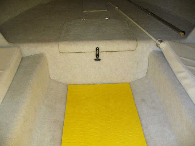

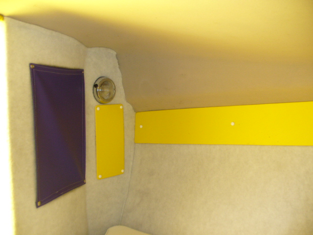

Default The cabin
Let me knw if you need more
Attached Thumbnails Kryptonite project begins....-krypttransom013.jpg   Kryptonite project begins....-krypttransom015.jpg   Kryptonite project begins....-krypttransom019.jpg
DonRoc is offline

No back cushions. it is actually pretty comfortable without them. And we are hardly ever sitting in the cabin
The boat my customer has does have backs, he also had the logo embroidered in all the cushions and the cockpit rug, plus a v berth cushion. But he hits the poker runs and sleeps over on the boat. Really nice but I don't have pictures. I did put a purple rug in mine really cleaned it up and set off all the yellow.
