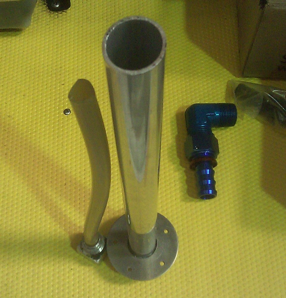

I am installing the fuel system and some new gauges in anticipation of the motor getting off the dyno very soon... The pump is a Aeromotive Eliminator, the gauges are boost and fuel pressure. here are some pics of the monster pickup... you know when the suction side of the pump is -12 (3/4") the 3/8" stock pickup will just not do.... 3//8...3/4.. doesn't sound like much but next to each other WOW is all I can say...

Its all trimmed, angle cut and deburred, I took the picture before I sized and angle cut it...
I have the new hole cut in the fuel tank for the pickup, and the fuel system mocked up. Tomorrow it should be done. I have the electrical side about ready also its a dual relay system. This weekend I plan to move some gauges around and install the fuel and boost. I will post some more pics over the weekend..
