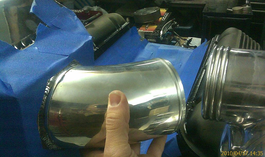

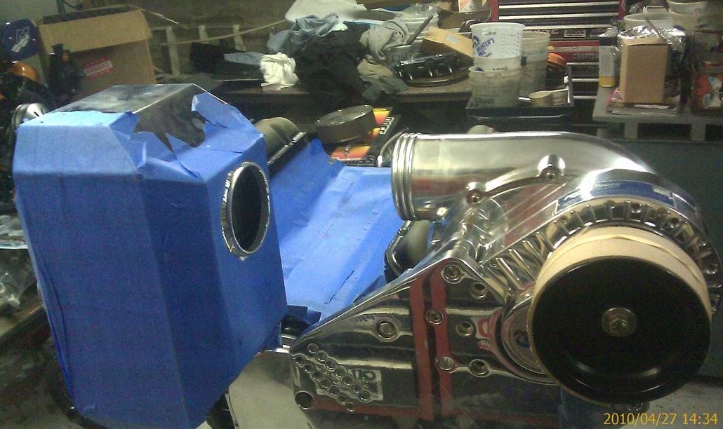

These are some pics from last week, some custom work on the intercooler. We had to cut the inlet off redesign it and weld it back on to match up with the blower.
The paint was just done love the color, its about an exact match to the purple on the boat.
The rockers are set up with the proper length push rods.
Ready to put some accessories on it

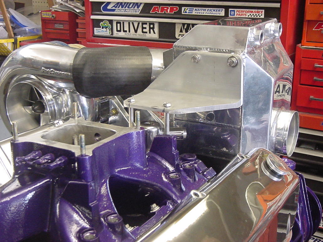

Some accessories are getting put on. The custom work on the intercooler turned out perfect. I am up in the air about painting the valve covers purple... The polished look is cool for a few months then its all work to keep it nice... check out the custom one off support bracket for the intercooler. The factory bracket wouldn't work without the carb box, plus it was stamped steel (more like tin) I imagine the cooler gets heavy full of water and all the bouncing the boat will take we really want it to stay hooked to the motor. Just needs to be painted or polished?? Jason Saris just does some awesome work.
Lots of the missing EFI stuff came in, things are coming along good now, cross your fingers for me.

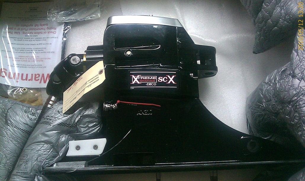

Also the SCX is on its way. I opted for just the upper, IMCO said at the speeds I would be running the SCX lower would lose about 5mph, I cant have that. Plus the SC lowers really dont break they just just make noise and need new gears every 50 hours or so... never know I may try the SCX lower if i get pissed about repairing the SC lower. Brett @ BBlades is making me a custom prop so I can use my -3 on a standard upper. Remember all my work setting up the drive height to perfection and reglasing the transom and raising the X 2"... now I can still have it. I am getting pumped. Funny I dont get excited about much any more but when Jason and I were working on the engine Monday he was talking about how fast and how much power it was going to make. I was just smiling, felt like a kid getting a lap dance for the first time, lol...

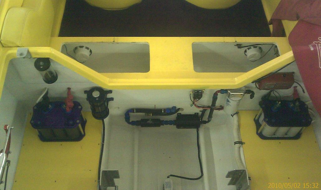

The new fuel pump and system. The other pic is a seperate water pickup and strainer for the intercooler alone. Is that a big cooler or what.... It will be in paint soon.
