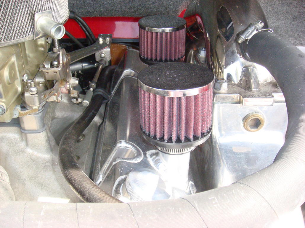

Uncle Dave you got a gourgeos looking boat and that engine and compartment looks like you can eat off of it.
innerrage is offline
Old 03-27-2011 | 09:59 AM
Joined: Jul 2008
Posts: 2,801
Thanks sir, very nice compliment.
I work hard at keeping my toys in good shape.
UD
