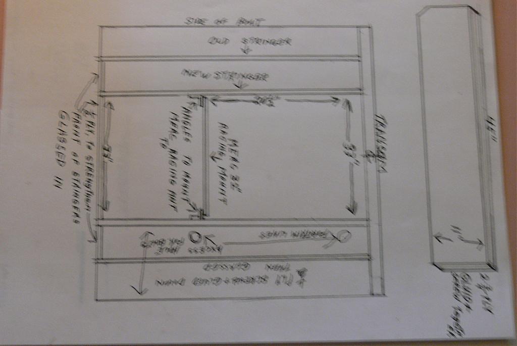

Bob heres a sketch of how i did Vixen.If this works i can ansewer anything about the sketch you might want tn know.The sketch on the right is the best.It showes how i built the stringers.I used 2 pcs.3 forths water proof ply.glued an srewed together to give me 1an half inch stringer.I gassed this to the transom an the bottom of the boat 33 inches apart because i was going to use a 32 inch Merc. racing mount.In the front i put 3 half inch ply between the old stringer and the new an between the 2 new stringers to give those new str.more support.This should give you some idea how i did it.We took some bad hits out there and nothing ever broke in the eng.compartment.

Thanks for the GREAT INFO!!! A couple more quick questions: did you cut the center stringer completely down (under the engine) Also, did you increase the transom thickness between the new stringers?? ps I'm actually in Ft. Myers now on a mini vacation! Again thanks for the valuable information!!

Bob,glad i could help.I didnt increase the trans. between the stringers because i didnt think it needed it with all the rear whgt.of the eng on the transom ass. and not on the stringer.I did in the front because most of whgt was on that front mount. After i boxed it in with the 1/2 ply over the top it made it like a tank,and made it very easy to sit on to work on the eng.I cut the center stringer flush at the trans.and as close to floor as i could get it with a saber saw,i think about 1inch.If your in Ft. Myers give me a call at 454-3002 an come over an check it out,i got the old gal inside tell after the storm season is over anyway.
