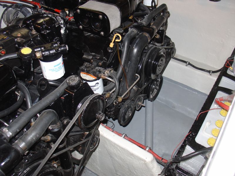

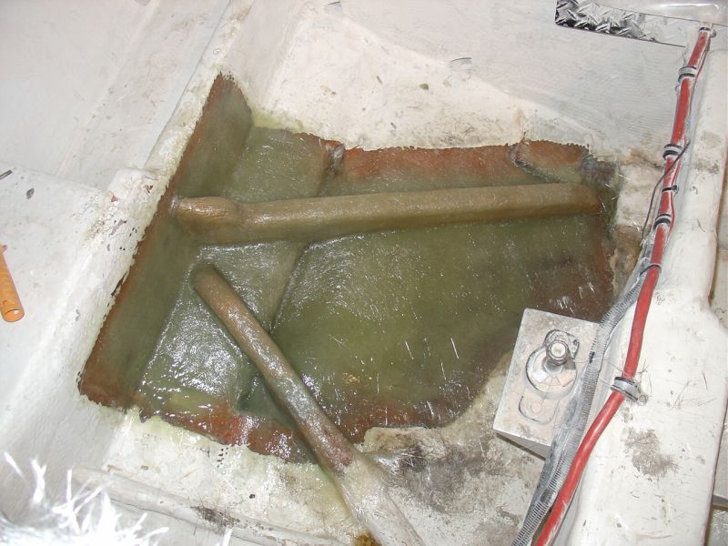

When I do such transom/stringer repairs I use birch playwood. Thats A shortfibre strong material and very nice to handle. I did some minor repairs in my -89 312 Stinger last winter. I Belive its a good idea to coat the bottom with a dark grey gelcoat when you had the glass job done.
Do you have any pic so we can try help you out here??!

nice look'in work Mange! alot of guys dont go through the extra effort to surface finish a repair area. nice

Hey Mange, Thanks for the suggestion. It looks like your project turned out pretty nice. Great work!! Glassdave... I checked out that link for the epoxy and I think that I will go that route. Did you use the thin kit or the thick kit? I'm guessing the thin.
