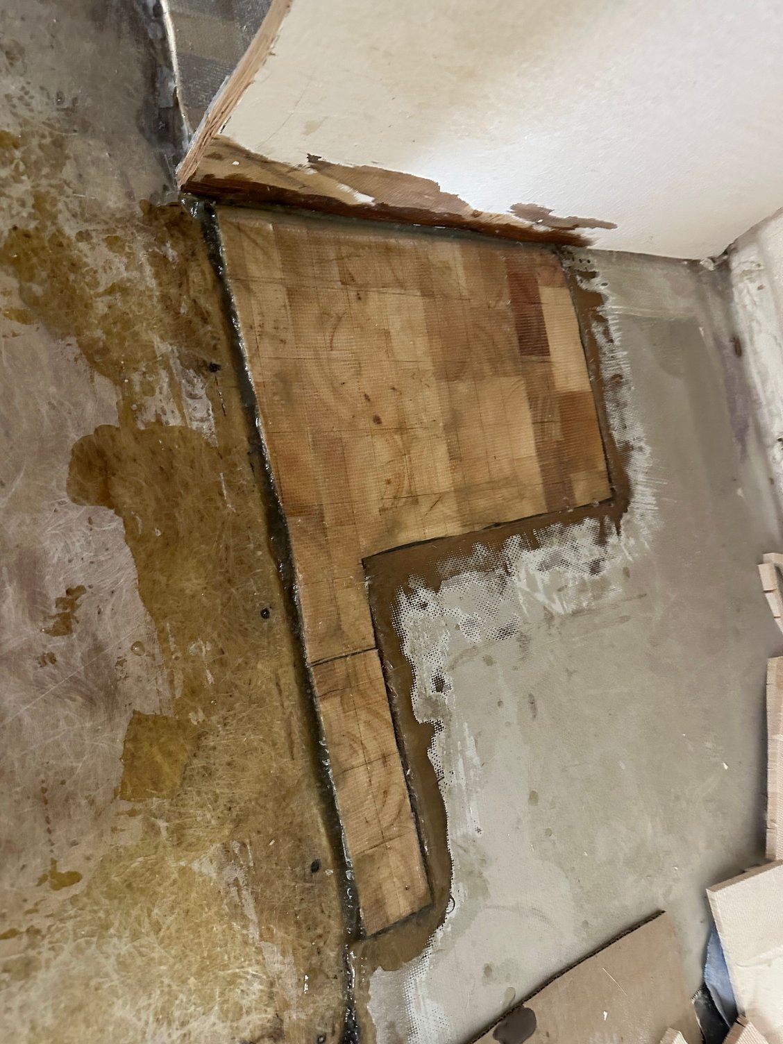

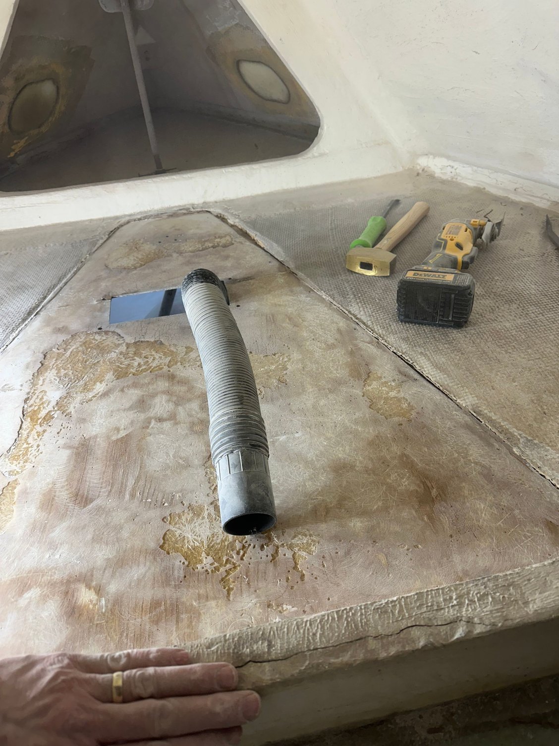

Default Hatch forward deck core
Rotted core removed, inside but tonight even my toes are itchy lol

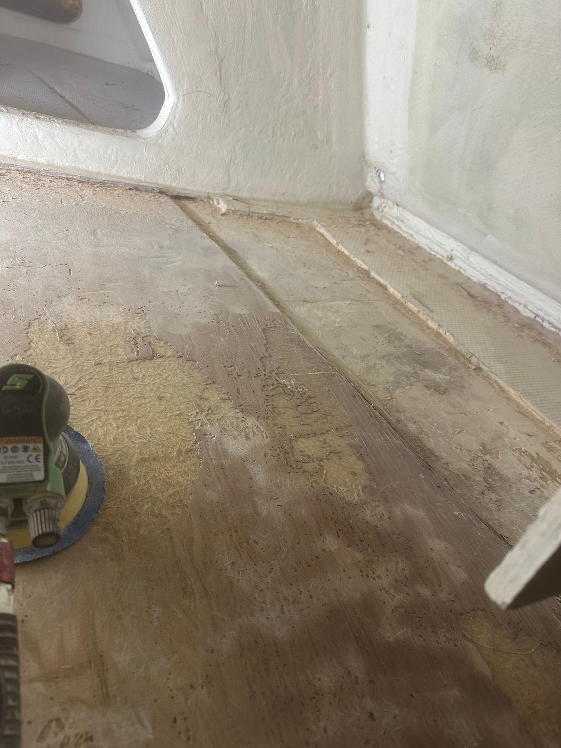

Default Chasing the water path
1/4 inch balsa core on insert backing and 3/8 on sides.

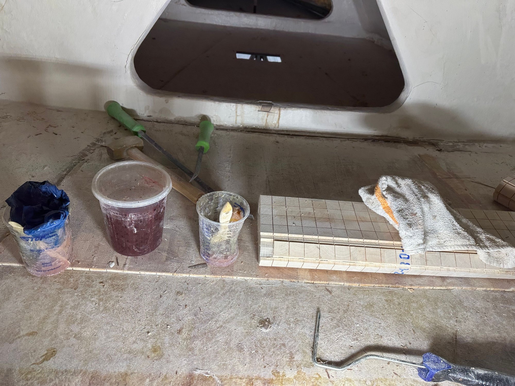

Default Almost half way, two more sections to tackle
Glass the section of balsa core tomorrow.

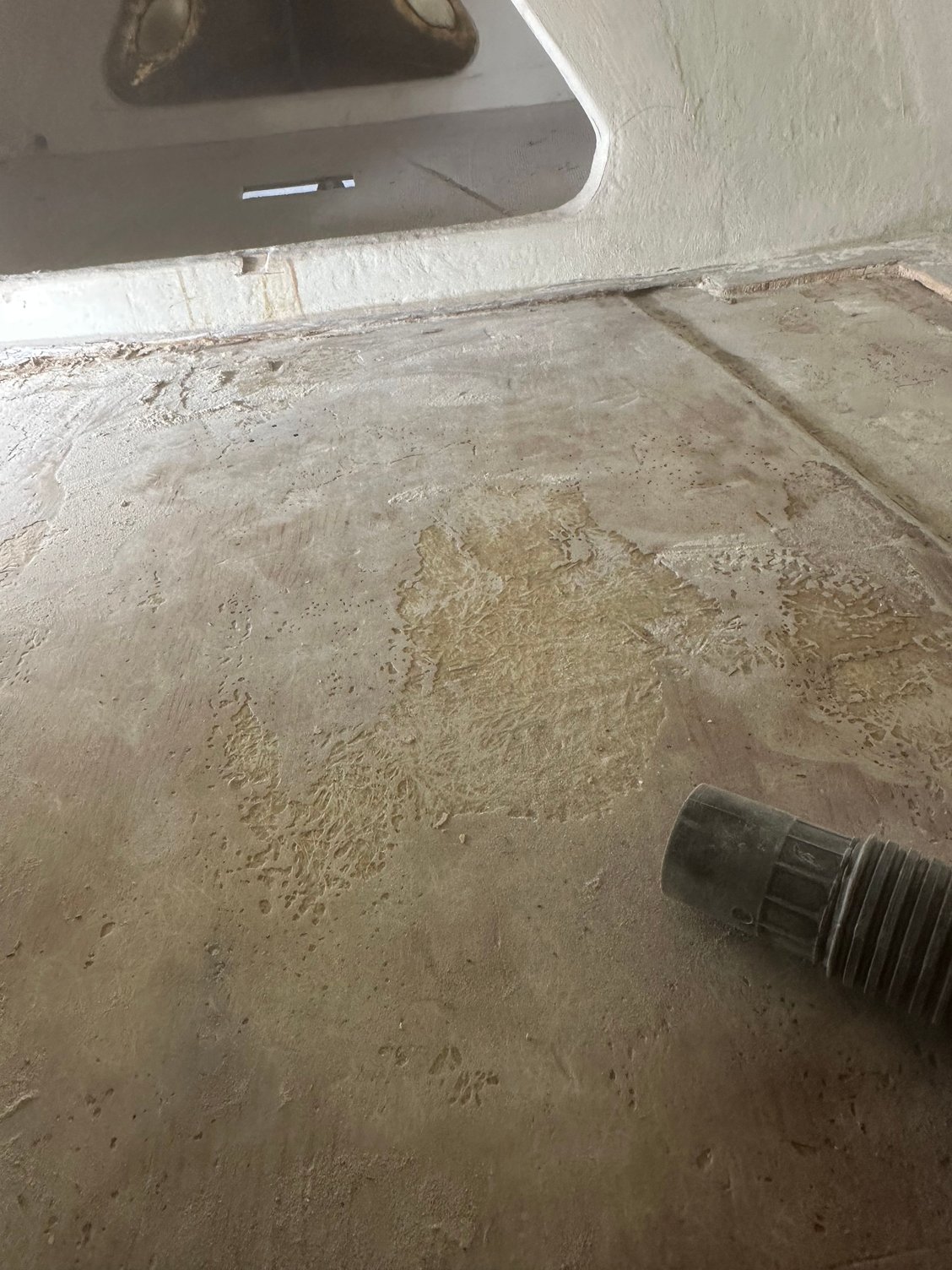

Default Moving toward Bow
Layer of 1708 topped with layer of 1700

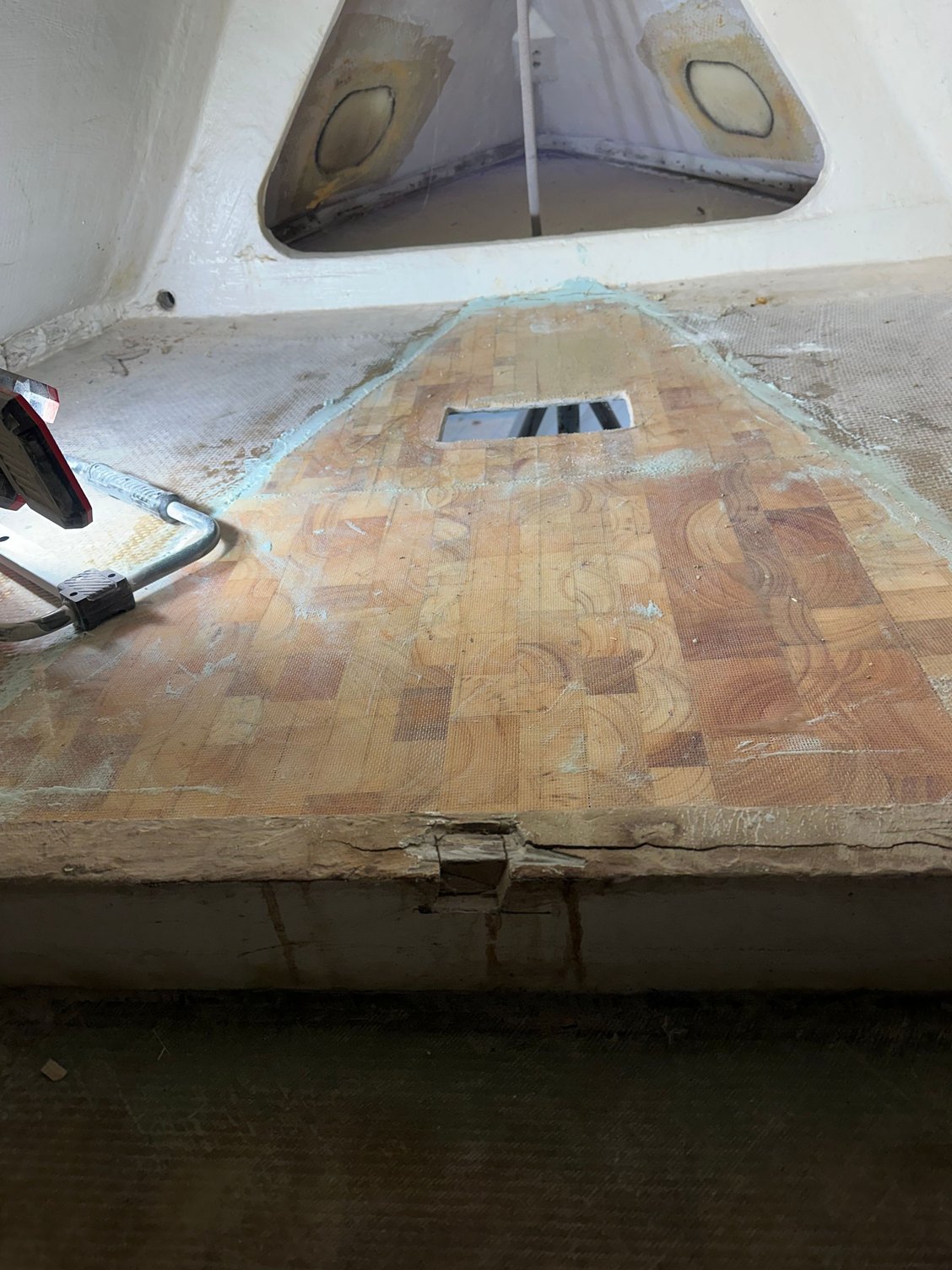

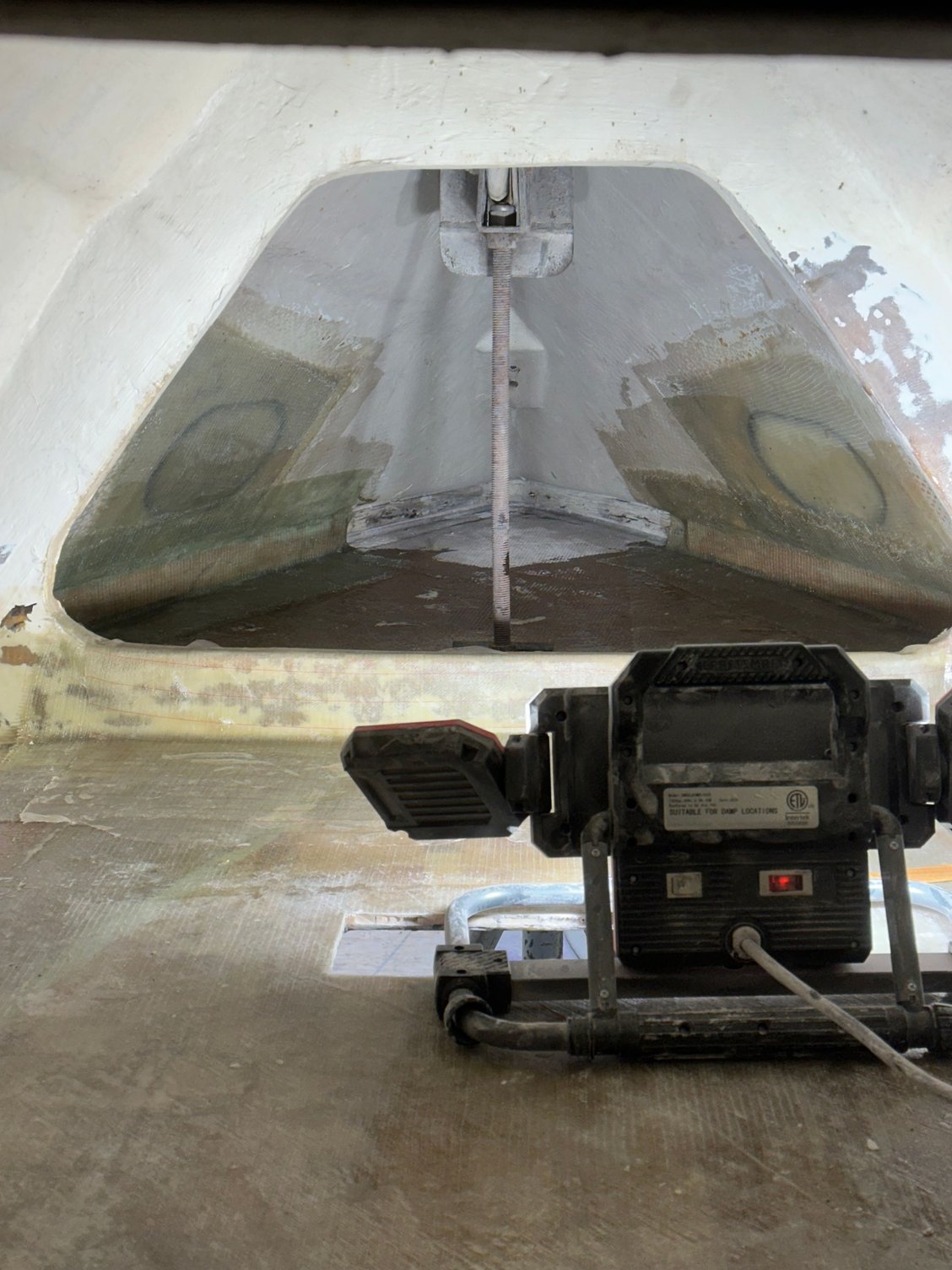

Default Getting tight heading toward nose
Was able to get the rotted wood out. Balsa core and glass next few days. After core is complete plan is to glass the deck to hull.

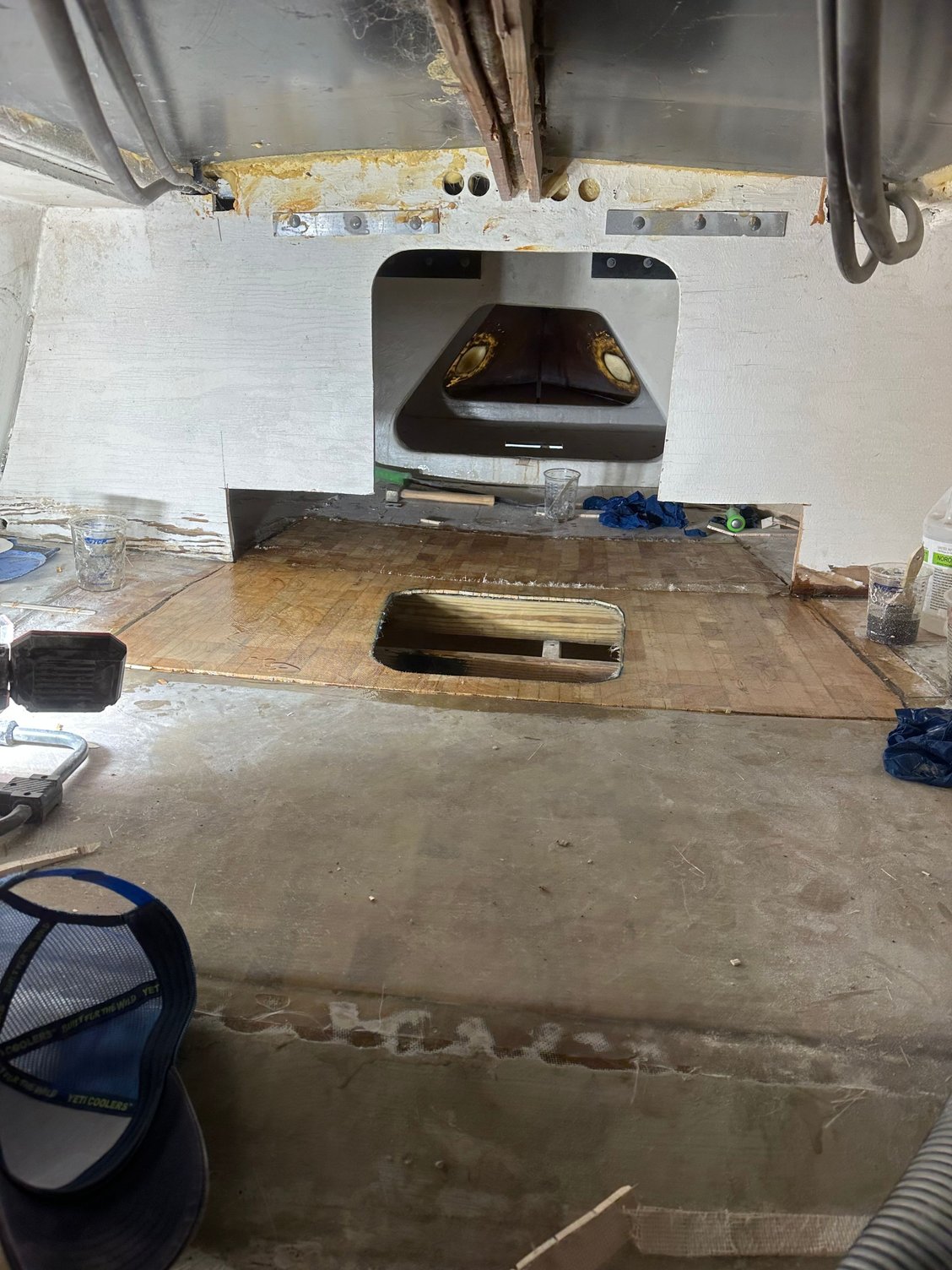

Default Balsa core matted in and glassing next.
Tight area to work in

Definitely glass the deck down to the hull...they have separated with bad results.

Default Now working bow to stern
this is as far forward as I could reach. 3/4 marine plywood with LPI 745 bonding agent and 2 layers of 1708 tabbed. Bolting though when dry

Do you still have the triangular deck insert?....
