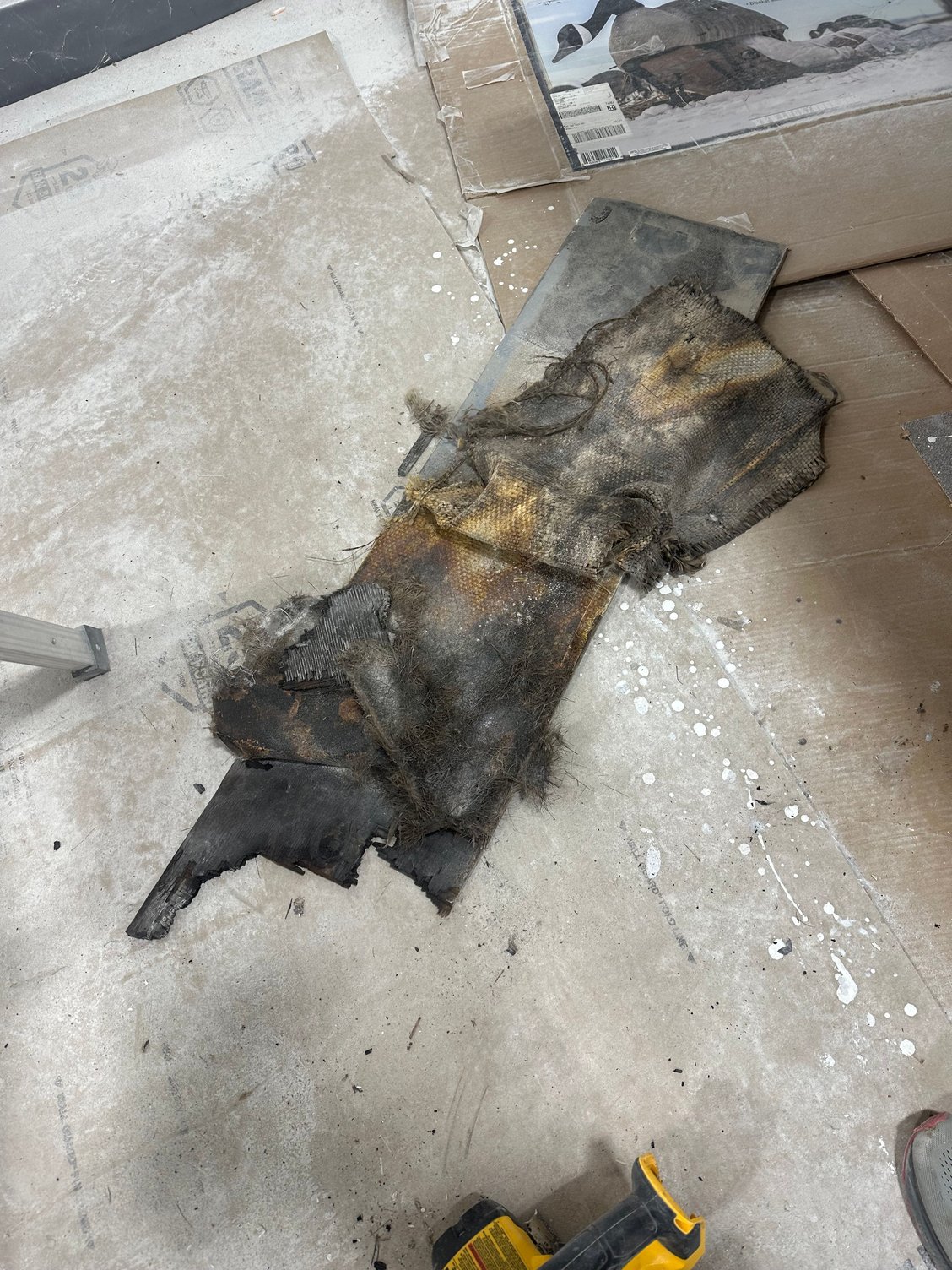

From: At Work

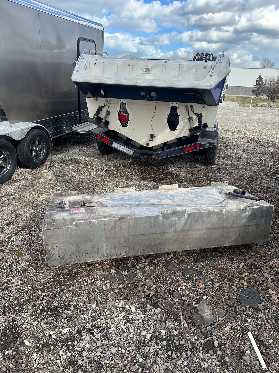

Default Tanks pulled, boats stripped. Heading to crusher tomorrow

Sport has brand new tanks in it when I was working on the boat previous before it was flipped for bottom repair. Sliding the Baja fuel tank in the Wife's body shop scrap container this weekend.

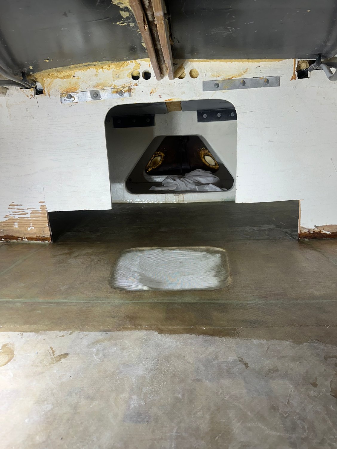

From: At Work
Default Fuel tanks
Tanks are above 👆 in picture. Black epoxy on them. Brand new over 6years ago. lol

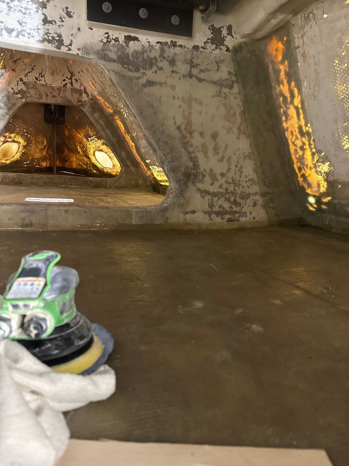

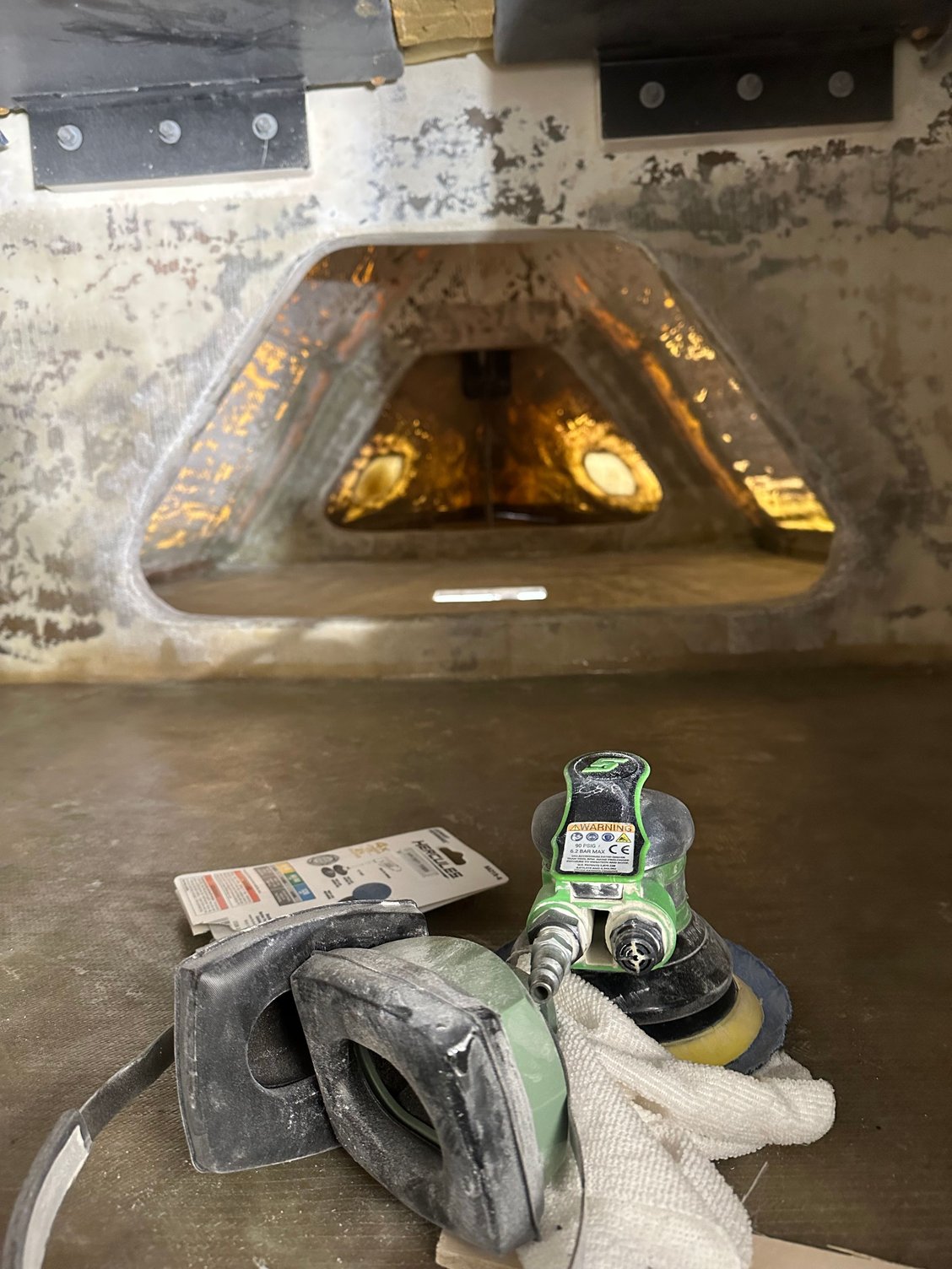

From: At Work
Default Back to the itch
One layer left of 1700 and ready to gel coat the cabin roof

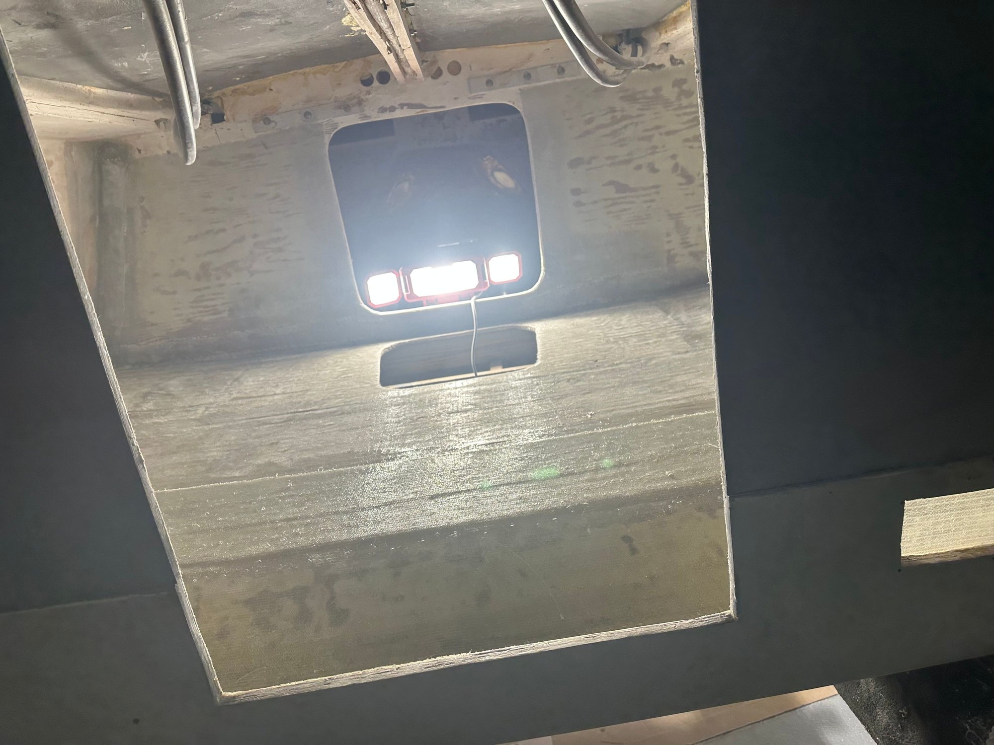

Default Cabin roof
Cabin roof is complete have to sand and roll some gel coat

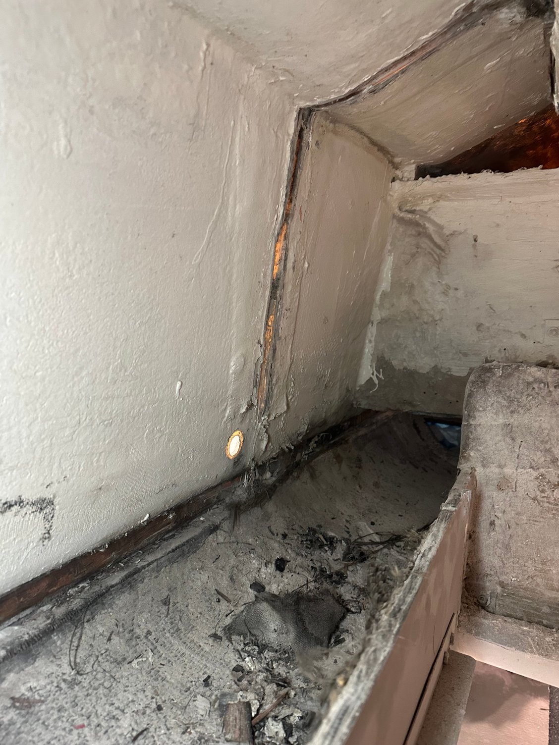

From: At Work
Default Cabin and engine bay

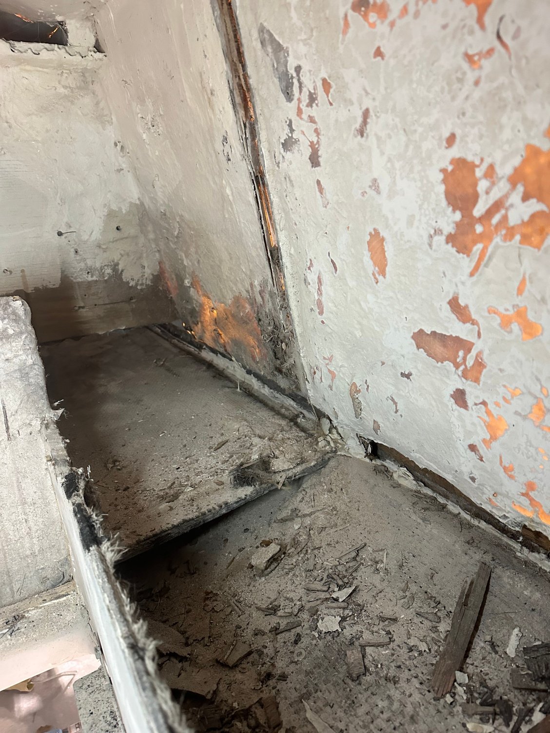

Found the wood under side air vent rotted. Cut old piece out and going to add coosa. Damn OCD

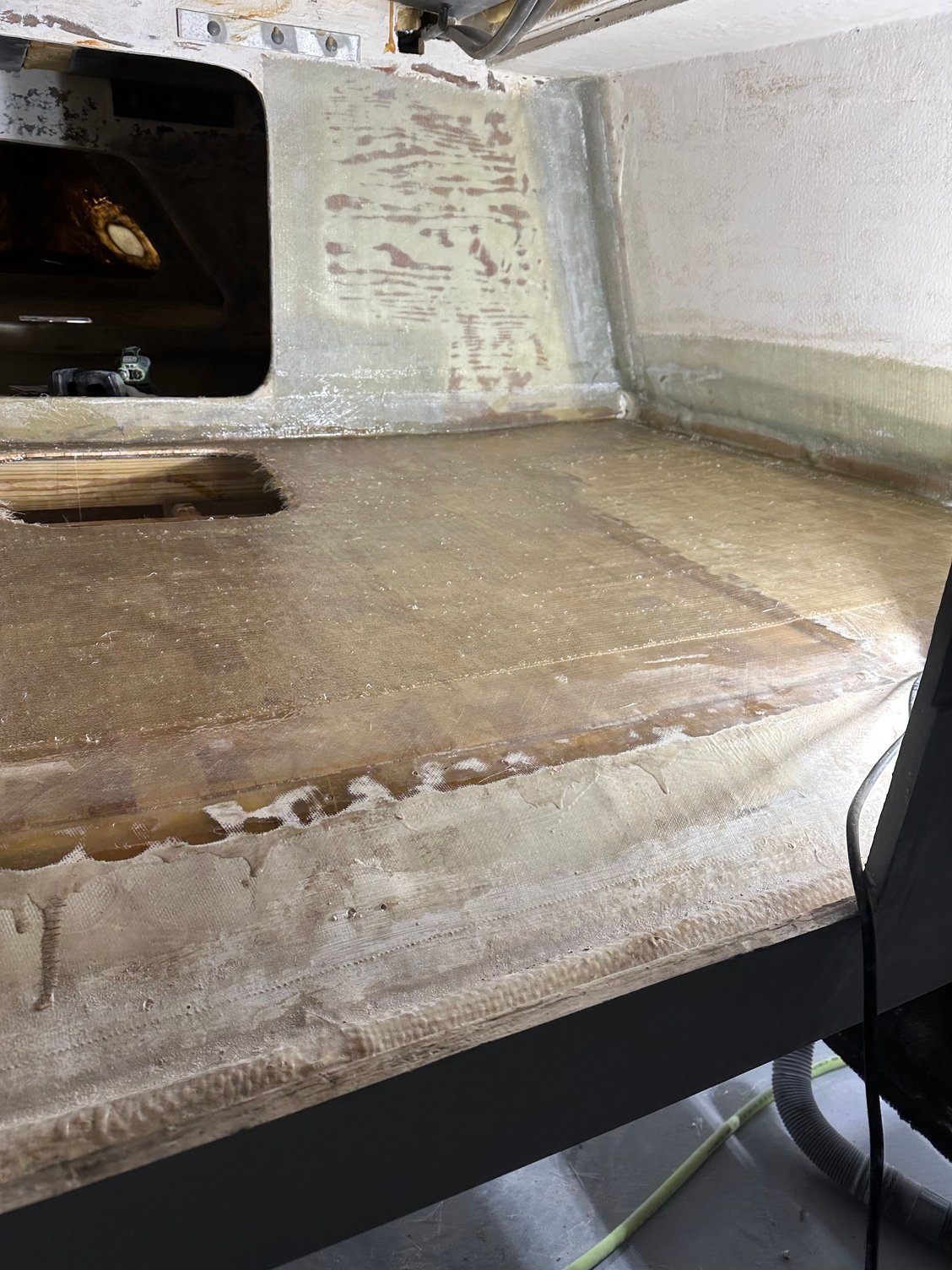

From: At Work
Default Working on gunnels

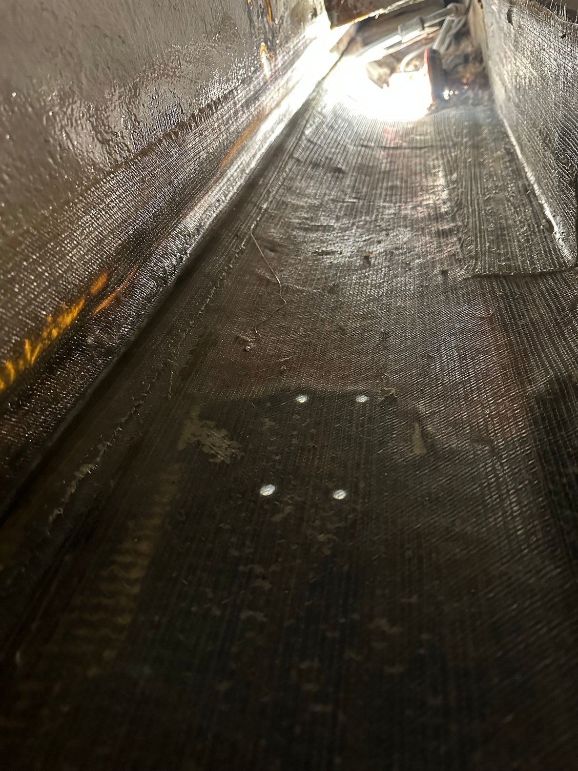

Old heavy weave mat was loose and removed all I could. Tabbed deck to hull and slapped some 1708 Times getting shorter to work on it for me with work
