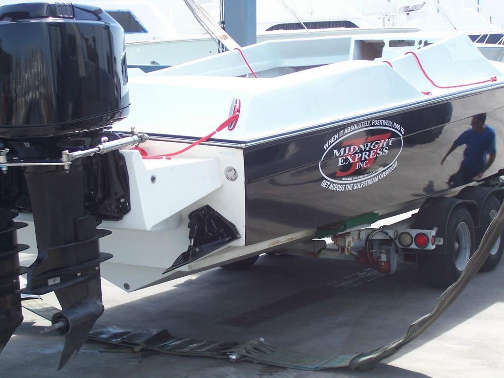

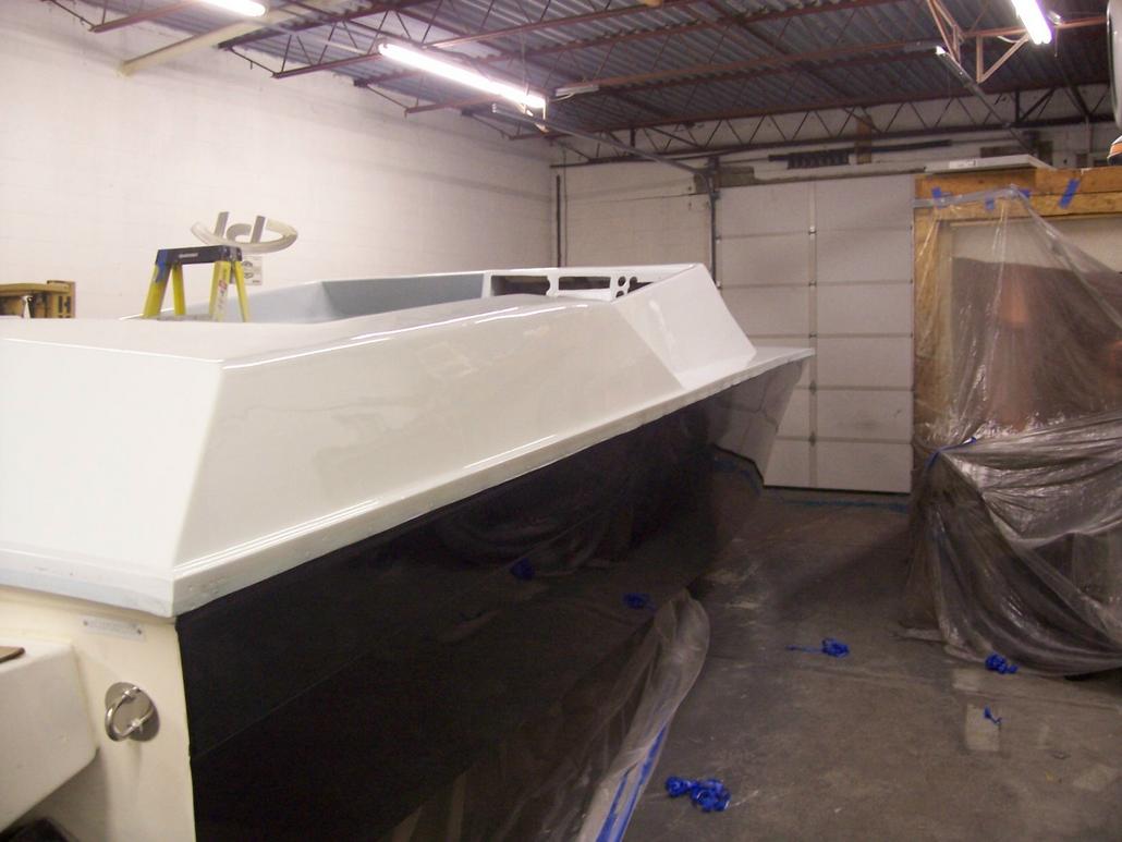

I need a race faring for a 37' to replace the windshield. Will have the windshield for sale if anyone wants it. I think Mike Britin @ b bracket used to make them and they are out of business... any other leeds would be appreciated.

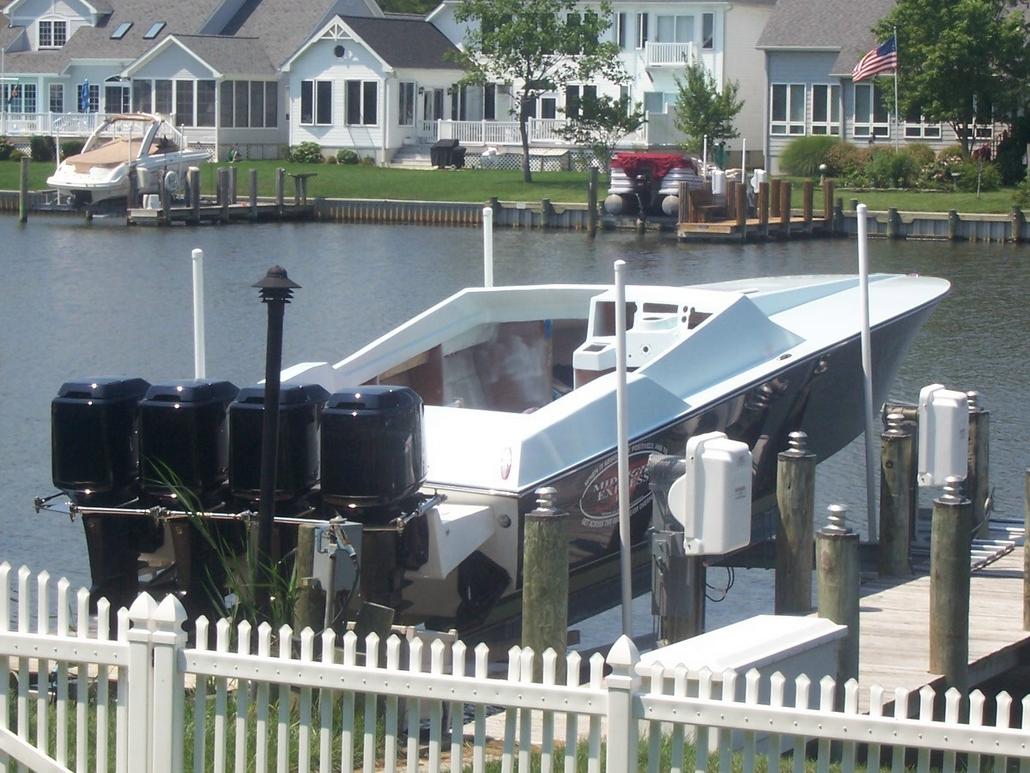

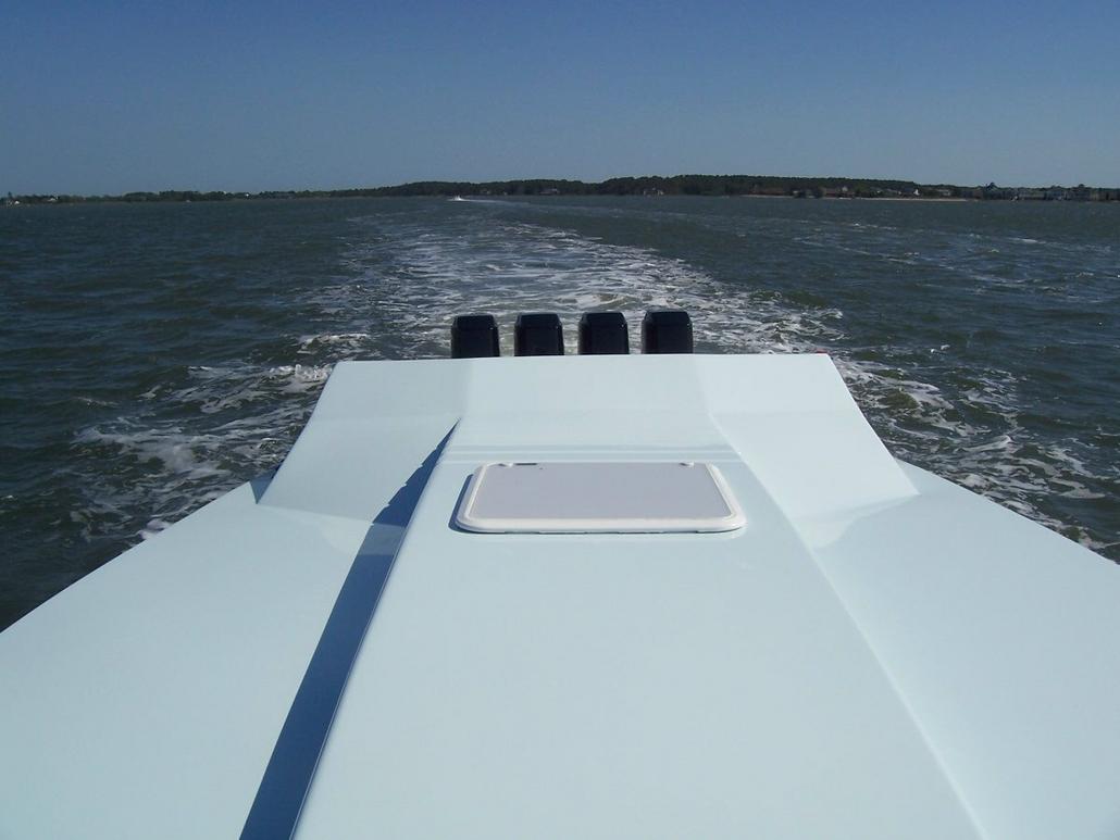

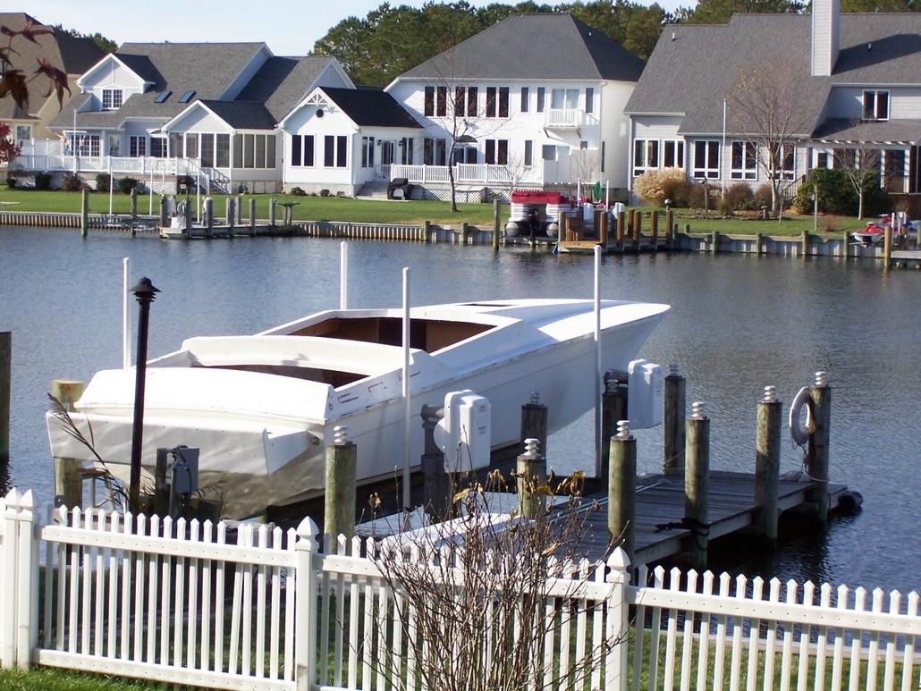

Mid Ocean not sure if u have been reading my posts last 37 Midnight, I built my own fairing out of divinycell.
I made the patterns first to liking out of the 1" pink foam 2x8panels you buy at home depot.
After a few scribes and photo shop on computer at home
I found the look I liked and made the patterns out of pink foam then copied them onto divinycell.
I molded them into shape, took them back off glassed them and then glassed them on the boat.
I did the same with the "handle inserts on port and stbd stern quarters
I know a real pain tin the ass but maybe you could do the same with ann aluminum fabricator once you have your own pattern.
I didnt want to go that route due to lack of metal shops where I lived and past experience with them.
I alkso raised my dash/helm area which led to me having to set back the entire dash and fairing.
I am extremely happy with the results

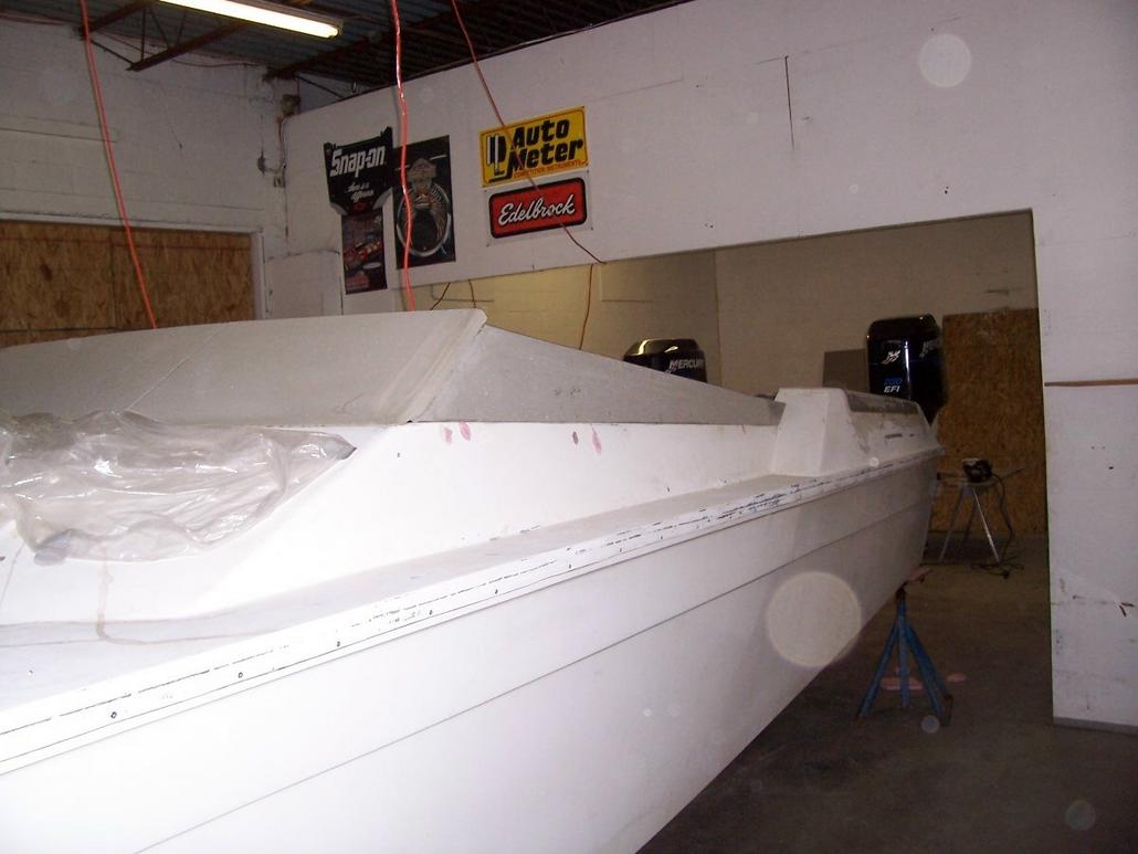

heres some more

hope this helps!
And the last pict back home......where she now sits awaiting upholstery

Excellent job.
I was thinking of making a Malimie mold over the windscreen to get the proper angles and then pull a part off of that. I could put the core... maybe nidacore into then... I really like what you ahve done..
