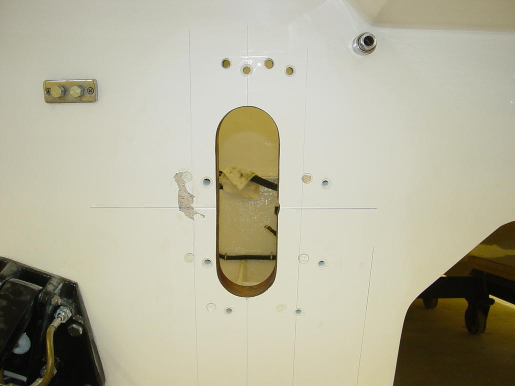

Thanks for the response, we will try changing rotation when we get it running better. Any chance you know what your X dimension is? Or how high above or below the boat the centerline of the drive is. Nor-tech had me set the drives up at 22" high and 8" from the tunnel which looks to be (without checking for sure) about 1 1/2 inches above the bottom.
I just looked at your pics and you do not have the notched transom, your x-dimension and mine will be different. The boats with a filled in transom from my understanding had higher x-dimension then those that had the notched transom. Having said that a friend of mine has an 04 36 that has the same transom, I am going up north tonight for the weekend and will have a look at his boat.......I will get back to you.
