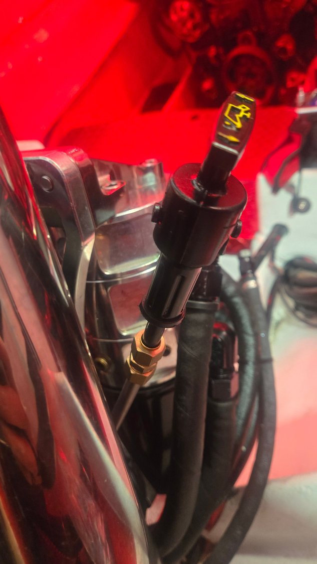

ICDEDPPL 01-12-2026 06:20 PM
I`ve struggled with dip sticks and leaking thru out the years.
I`m going to try something diffferent this time around.
Modified Moroso locking dip sticks.
I`m hoping for no more leaks.
https://cimg1.ibsrv.net/gimg/www.off...7fd046ca28.jpg
https://cimg2.ibsrv.net/gimg/www.off...9c46c79169.jpg
Helmwurst 01-13-2026 08:31 AM
Leaking at the block or out the tube on top? That sounds like you have too much pressure building up in the crankcase, maybe?
ICDEDPPL 01-13-2026 09:49 AM
There`s always crankcase pressure on a blown engine.
The crank whips oil in the tube and the pressure takes it out the top.

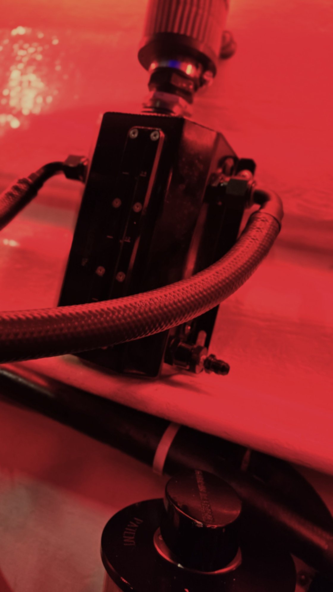

ICDEDPPL 01-13-2026 05:50 PM
Vacuum pump and dry sump would definitely do the trick but at a cost and added complexity.Would be hard to incorporate now.
I had -6An lines going to a catch can and the breather only had a 1/2" opening .
Upgraded to -12AN and 1" opening

LakeBoat4 01-13-2026 07:57 PM
That is a good upgrade. I would suggest (2) 12 an lines to the catch can. One from each valve cover. Then a 1 inch opening or larger to mount a bigger filter on. It is not that much to do a Moroso Vaccum pump and a longer belt to your system to drive it. Think they still make them. It will acually add HP too. This was done to my SS Hemi car and saw 30-35 HP gain.
Craney 01-14-2026 03:48 AM
Look at the picture above your post
LakeBoat4 01-14-2026 10:43 AM
Look at the picture above your post[/QUOTE]
I did so whats your Point? Instead of Help someone you Criticize, maybe an ego issue, Bro...
Looks like (1) 12 an, the other hose looks smaller. The tank exit still looks like it is small and stepped up at breather, a restriction. Going back a few post and "reading" there is positive crankcase pressure causing the problem. I'm pointing out the fix not critical of a photo.
ICDEDPPL 01-14-2026 11:28 AM
Easy buddy.
The picture shows two -12AN one from each valve cover and a -20AN breather, which is 1' I believe .
The description is:
