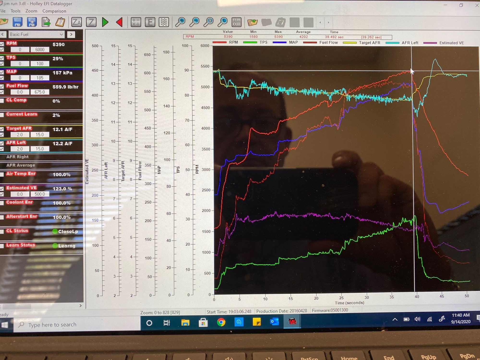

Almost exactly a year later, brand new PSI block with 10.6 pistons, HP3 heads, Raylar 206 cam, porting, on the crap procharger 496 blower we produced 2.9psi and made a whopping 1013 hp max tq was 925 at 5700 rpm the blower was dust and the old style straight vain. After dyno session, someone mentioned that Procharger has a hotrod/development shop. I sent a spare blower I had to them and gave them the specs of the dyno pull and for about 2K they returned 9 inch impeller style but much wider and bigger blower that would fit my 496 dressed engine. The claimed it should make about 8-12 lbs depending on my rpm. They also upped the max rpm it could handle. Its now able to spin 60K plus. Well, that messed all the fuel tables and ignition etc. SO my friend, Jim the owner of Arizona Speed and Marine sat on my boat and we ran it and dialed it in, during the most aggressive run we hit 100 mph..............scariest thing I have done in a long time. The speedo line blew off the back of the speedo and drenched the back of my dash etc. We had been having some crazy high rpm fuel issues and come to find out my pre pump fuel filter was clogged and my fuel pressure was not set right, we were about 13lbs off, meaning dash gauge showed 43lbs and the rail was at 30 psi..........I can spin the 32P labbed (mercury racing did it) bravo to 6500 rpm Frankly guys moving that fast on a small lake is terrifying to me. We were at Lake Pleasant in Arizona. Ill get my simrad to record some GPS for you naysayers that wont believe until post some pics........but here are few i thought you would enjoy. Thanks to Jim who did this on a 115 degree day here in Arizona. ASM and Jim are amazing people..........remember if you own a blue top merc motor Jim and Arizona Speed and Marine designed and built it. He builds/casts all the merc blue motor intakes. With new blower we are thinking we have close to 1300hp going from 2.9lbs to 8.7lbs......I had a blower belt jump and it still pulled 78 mph through the dead blower lol.

Here is a data log from Saturday 32P prop gps speed at 90 8.2lbs of boost and 30% throttle
