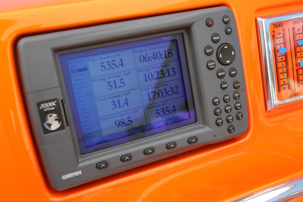

Since we're talking 39's, I've heard they're a real handful to drive... tend to bow steer. Any truth to that? I've never been on one and was curious what others have experienced.
Shallow Minded is offline
Old 11-22-2011 | 10:47 AM
  #36
OL40SVX's Avatar
Joined: Jun 2003
Posts: 7,276
Likes: 23
From: Bristol, RI
No bow steer. They're a nice running boat that needs some negative tab at higher speeds. With none they'll walk on you a little bit. Here's the GPS shot of What a Rides boat after delivery.
