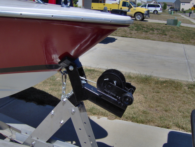

I went out and worked for a few hours, and this is where I currently stand.
I did the trailer hitch and bow-stop a few weeks ago.
Attached Thumbnails WIP - Work In Progress-hpim0990resize.jpg   WIP - Work In Progress-hpim0938.jpg   WIP - Work In Progress-hpim1020resize.jpg

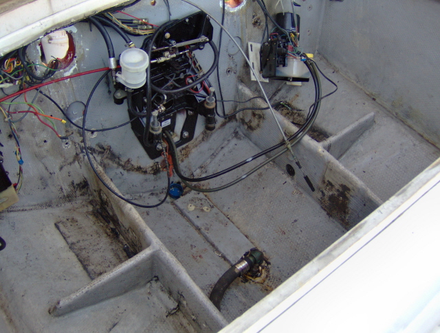

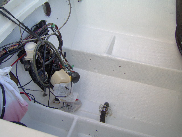

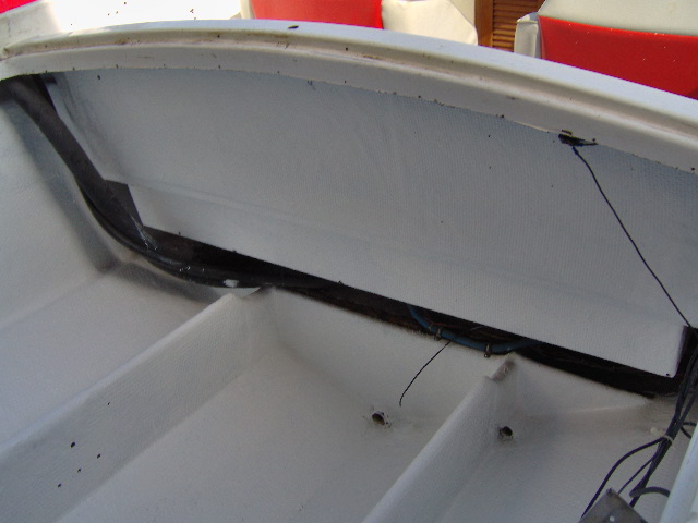

here's the difference in the bilge.
I just went with Interlux Bilgekote - scuff it, acetone wipe, and lay it down. This sh!t is kinda slippery though.
There were a few unused mounting holes in the transom and stringers, I filled them all with resin and dowel, and then glassed/duraglassed over them. I think it's coming together nicely.
Attached Thumbnails WIP - Work In Progress-hpim1055.jpg   WIP - Work In Progress-hpim1056.jpg

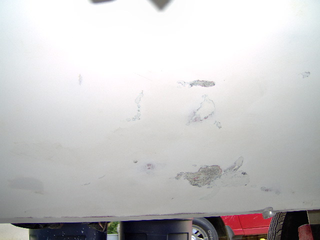

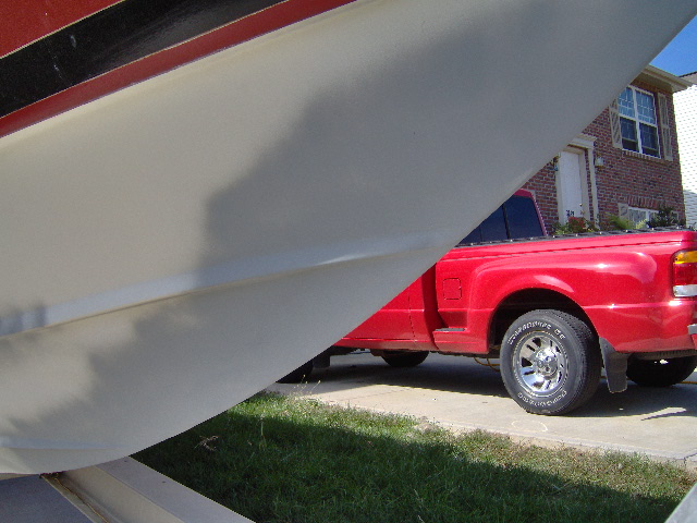

I'm working the hull at the same time.
Works out well, work in the bilge for a while, and while something is curing/drying, crawl under the hull and sand and fill.
Here's the bow that I already touched in, and todays fill in on the aft of the hull.
I'm using the gray sandable primer as a tracer coat to see if I feathered it in properly, or if there are any "pock marks" that I need to fill.
