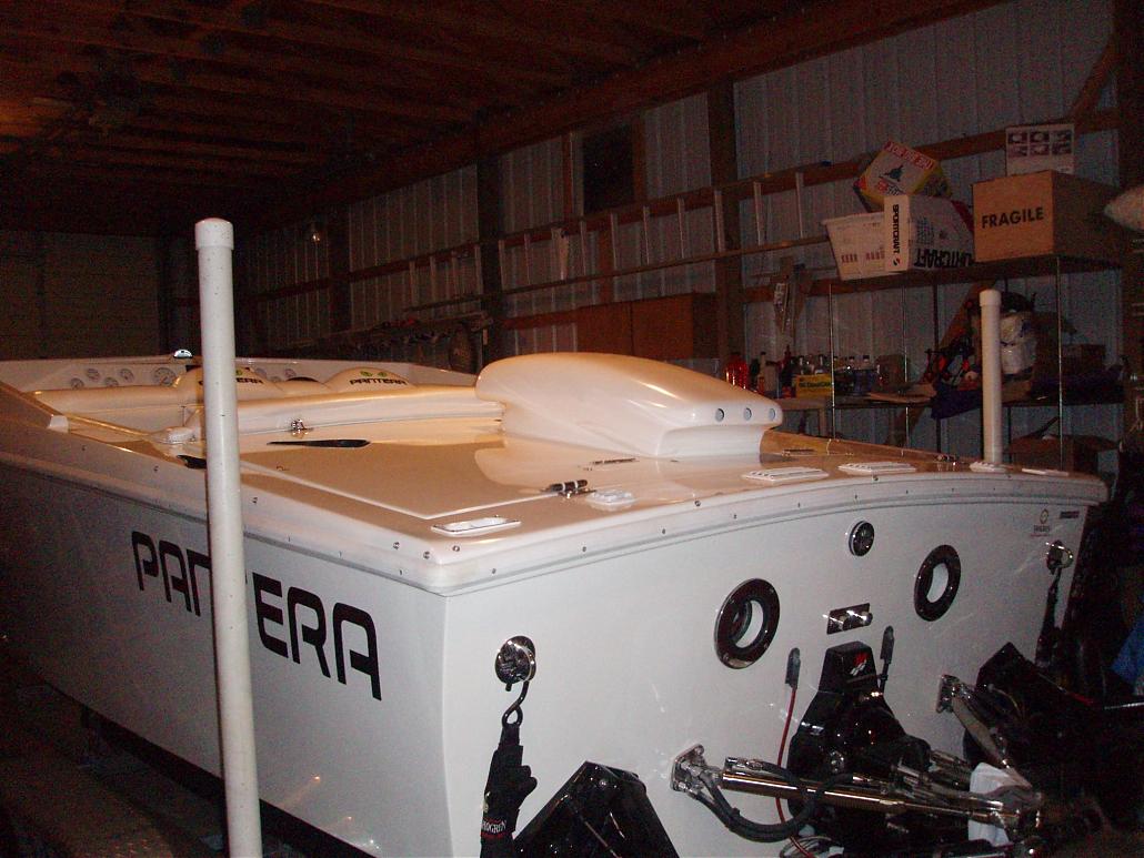

Not sure exactly but it obviously needs a clearance hole ..... maybe Jo/Pepe has the specs?
Attached Thumbnails engine hatch clearance-large-5718.jpg   engine hatch clearance-p9220247.jpg   engine hatch clearance-large-5716.jpg

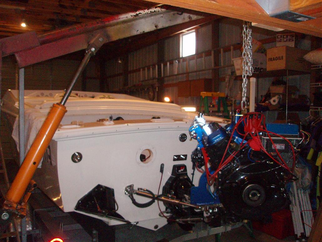

One more pic, sorry they are not at the right angle but they are all I have of the old motor.

It will also depend on if you have a notched transom. The engine sits about 3" in a notched hull boat.

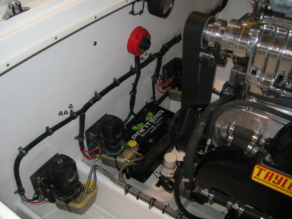

Based on the 525sc fit in a notched boat, I'd say your looking at about 8-9" above the hatch. It will also stick up farther above the hatch toward the back. My hatch had a recess glassed in about 1.5" for the arrestor to fit. I'm guessing the 871 is about 4" taller plus 3-4" for the chiller.

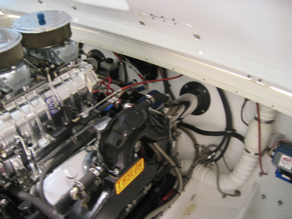

No dimensions but a few pics. 8-71, superchiller and 3" flame arrestors at about 19-1/2" x-dim. The standard scoop is about an inch to low to fit the back flame arrestor...
Attached Thumbnails engine hatch clearance-sm_img_1095.jpg   engine hatch clearance-sm_img_1097.jpg   engine hatch clearance-sm_img_1098.jpg
