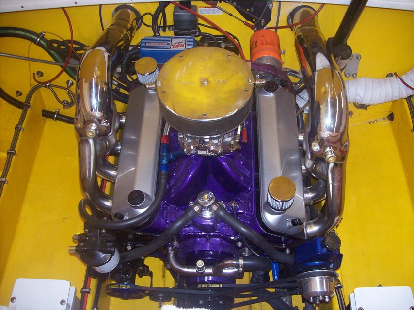

It was for sale in Maryland on Craigs list this spring. No clue who owned it or if it sold. It had 3's on it as I recall. I have a habit of "archiving" photos of 28s when they get posted on the internet so I can id the boat later if it comes up again.
