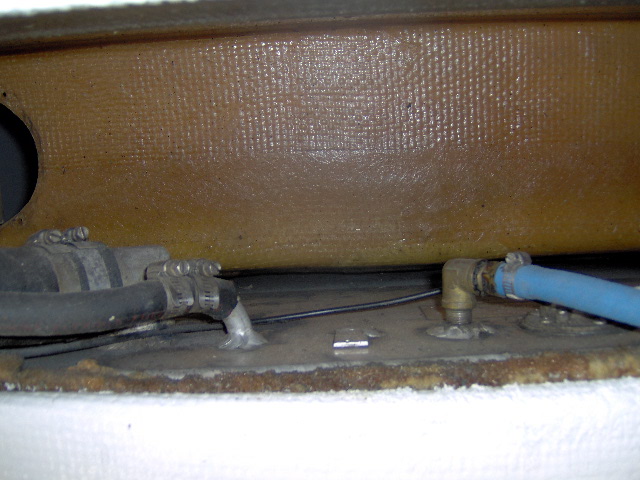

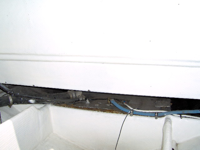

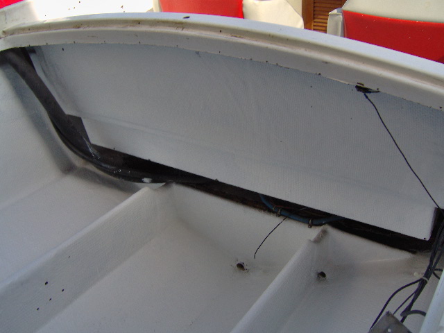

Yes, it's under the cockpit floor.
If you get in through the engine hatch, you can access the fuel hook-ups, on the Aft side of the tank. All the hook-up's are accessible under the rear seat.
I've spent enough time crawling in the bilge of mine.
Seeing as it's sitting in the driveway, I went out and took a few pics.
Attached Thumbnails Need help on 24-hpim1440.jpg   Need help on 24-hpim1441.jpg   Need help on 24-hpim1442.jpg

Few more - hope this helps.
It's not as tight as it looks in the pics, but you're not gonna get the tank out without a saw, and major rework.
Attached Thumbnails Need help on 24-hpim1443.jpg   Need help on 24-hpim1445.jpg   Need help on 24-hpim1056.jpg
