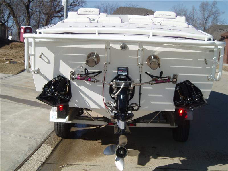

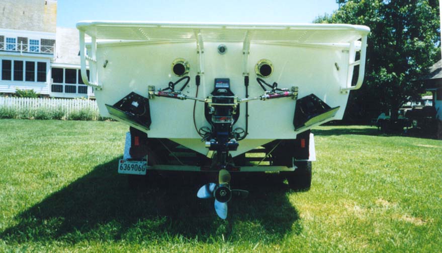

There's a 28 listed in the classifieds just a couple of days ago. Looks really clean. The transom looks strange to me. I don't know if its just a weird picture or not, but the bottom looks squared off. Almost like a fountain hull. Huh?

It has the notched transom. Some 28's have them, but most don't. Mine '96 28 had the notched transom. It puts cleaner water to the prop. Because of the notch, the X dimension is higher and you have to use drive spacers.

hey guys. I just bought that boat. does the notched transom affect the ride in anyway??
