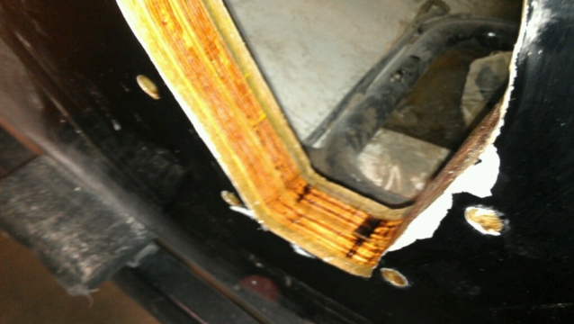

3 Attachment(s)
Attachment 471394
Attachment 471395
Attachment 471396
1.Cut the hole using this handy jig. Went conservative @ 17” X.
Decided to keep it a bit lower, may sacrifice a couple mph, but dont want the prop blowing out in a hard corner racing etc.....
2. Once the holes cut, put some resin in to preserve the hole.
3. HP gimbal assy

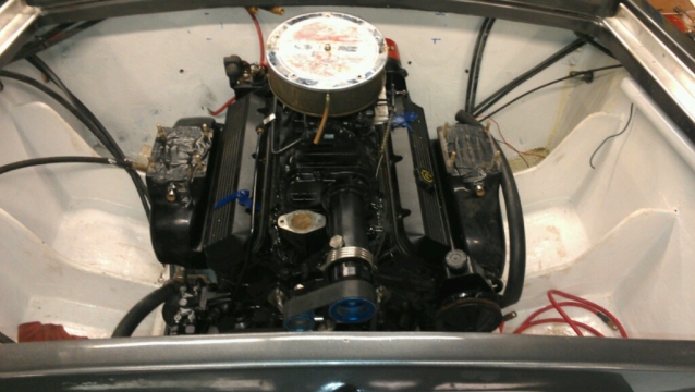

scarab63 03-25-2012 02:24 PM
2 Attachment(s)
Attachment 471405
Attachment 471406
Motor`s in & aligned.
Dart 454, dart heads, 177 blower,
not dynoed, but maybe 550 hp ?
Bit higher comp than a stock merc motor.
Biggus 03-25-2012 02:38 PM
Originally Posted by scarab63 (Post 3648816)
Looking good! How think is the transom at the cut-out?
