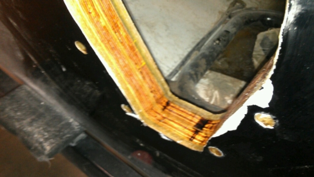

1.Cut the hole using this handy jig. Went conservative @ 17” X.
Decided to keep it a bit lower, may sacrifice a couple mph, but dont want the prop blowing out in a hard corner racing etc.....
2. Once the holes cut, put some resin in to preserve the hole.
3. HP gimbal assy

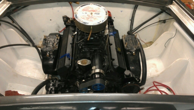

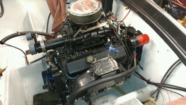

Motor`s in & aligned.
Dart 454, dart heads, 177 blower,
not dynoed, but maybe 550 hp ?
Bit higher comp than a stock merc motor.

Originally Posted by scarab63
Looking good! How think is the transom at the cut-out?
