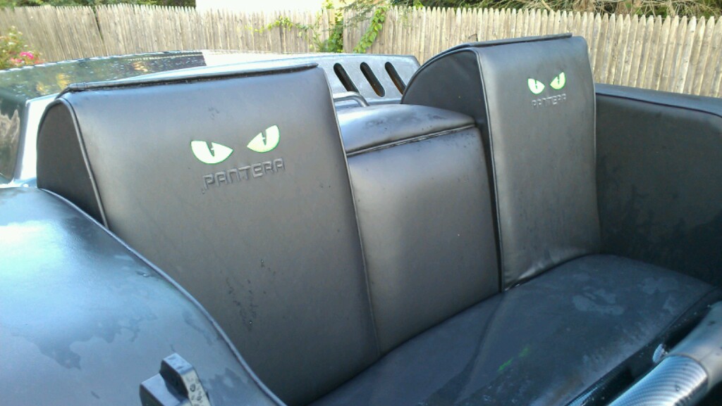

Interior pix
Was going to do drop out bolsters in this boat, but the cockpit is too small. When we mocked them up my knees were hitting the wheel sitting & def wouldn't work.
decided to use some of the existing old interior ( side arm rests ) and build a new bench seat.
I thought it would look cool to do speedster style backrest on each side and the middle is easily removable. I plan to build a cascading middle console so I can swap them back & forth as needed.
The headrest backs also give me a little dry storage. The seat itself is 11” of memory foam medium density, so theres plenty of padding.

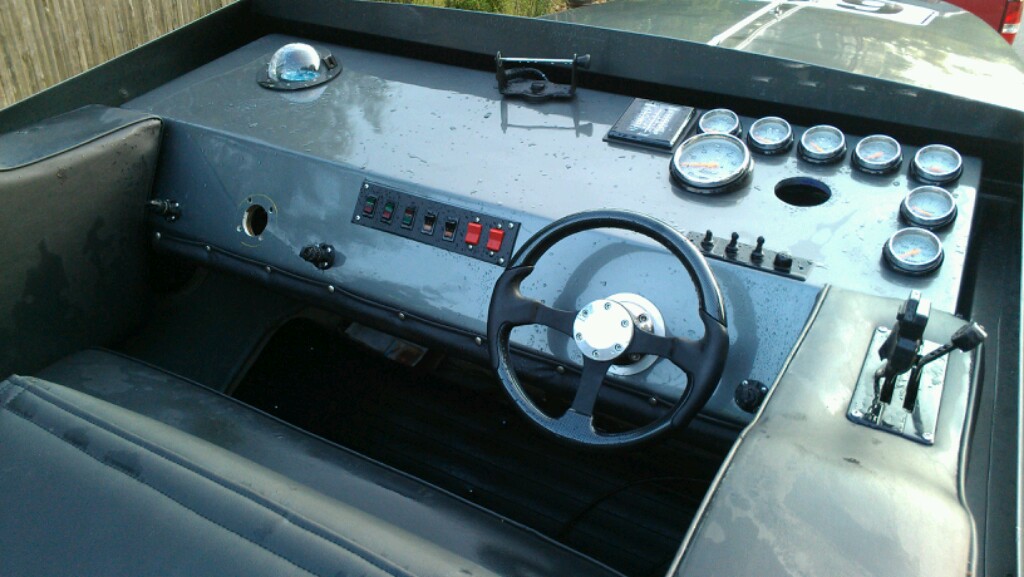

Dash pix
The dash is cut for two helms. For now ill swap em as needed. Next yr ill have two mounted with control valves under the dash to change flow to which one works.
Livorsi monster gauges in silver carbon look cool. Wish I took a pic of wiring under the dash....its spotless.

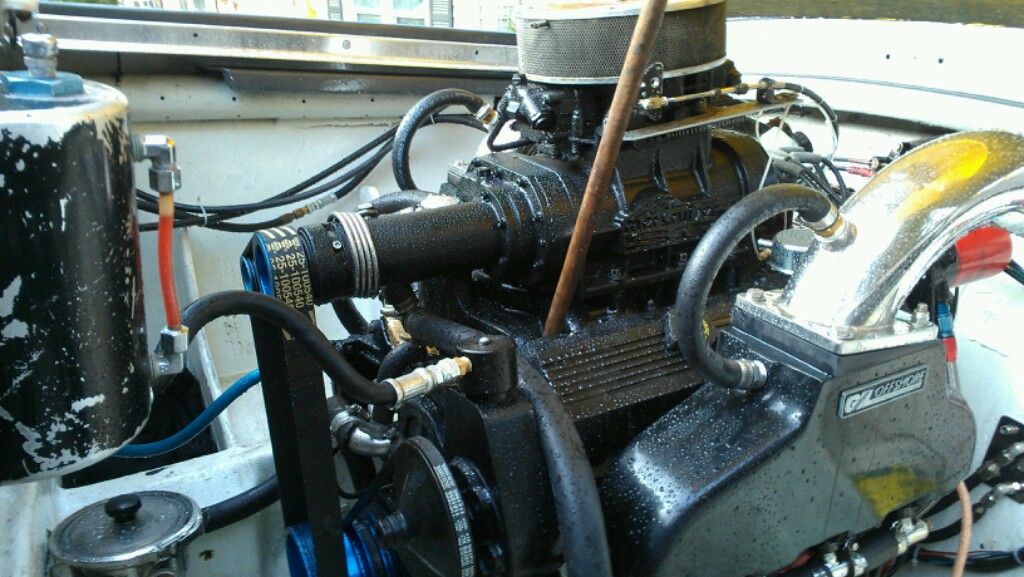

Bilge pix
Motor is a higher comp version of a merc 525sc.
Think I need more fuel delivery though. I leaned it out and pushed the head gaskets.
Dont expect to see it in the bilge next season. There will be some big pig in its place. At least 750hp

Interior pix
Dash pix
Bilge pix
