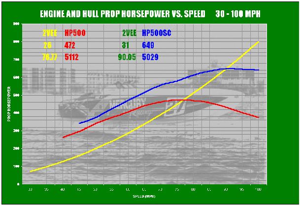

Using Von Bongo's numbers here's an estimate of power vs. speed. An HP500 gives over 75 mph...does that sound about right? If so, adding a Procharger for 700 HP would give 90 mph! Have fun at the dreaming and designing stage of getting the boat. IMHO, it's the best part.

The Carrabas 28 with a single HP500 is running P5 class , and I heard top spped was at 72 mph . Figure on a 575 to get that baby into the high 70s'.
