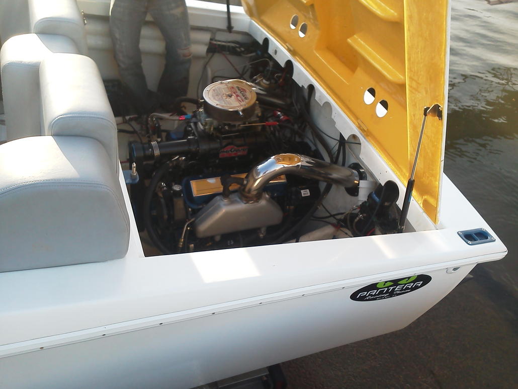

yeah those work pretty good. i will do some digging and see who makes the kits

mine is a super light hatch. those wont work on a traditional hatch. you have a light weight blower hatch on yours too right?

http://www.ebay.com/itm/TWO-90-10MM-...fc1caf&vxp=mtr
then just get yourself some struts. just dont get ones with too high of pressure cus it will bow the hatch when its closed. looking on ebay it seems they rate them by weight.
