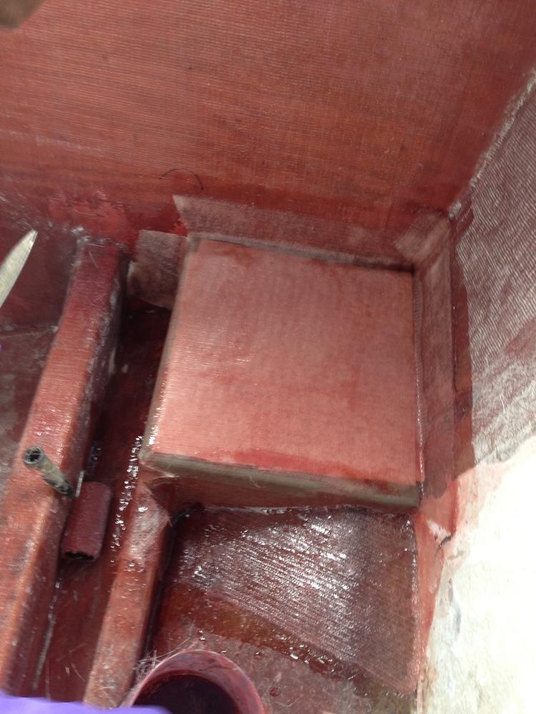

I screwed a block of wood to the stringers and resin coated it. Set the plywood down in cavasil and screwed it to the block of wood. Then did a coat of glass. Presto Battery supports lol
Just put mine in today, some foam wrapped up and good to go. I picked up the foam pieces at a local shop that they were getting rid of pieces and were just big enough

Nice work! Looks good. I wanted mine up where yours are, But i decided that i rather have some more weight forward. And took the easy route out lol

I was debating on putting them where you have them for that same reason but I said screw it, thought they would be in the way up there for or I was just used to have them in the back already
