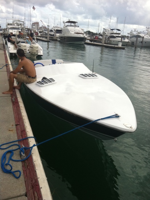

zavier24 04-02-2013 01:02 PM
1 Attachment(s)
Attachment 497337
This is mine now

rchevelle71 04-02-2013 01:14 PM
Originally Posted by zavier24 (Post 3897329)
Attachment 497337
This is mine now
Looks nice, you could probably get some lower profile new style hatches for it.
OCCJoe 04-02-2013 04:00 PM
I don't like the hatches myself , Couldn't wait to get rid of mine but the only one I ever saw that I liked was when littleshopofhorror did his Pantera and put that flush mounted painted to match hatch in

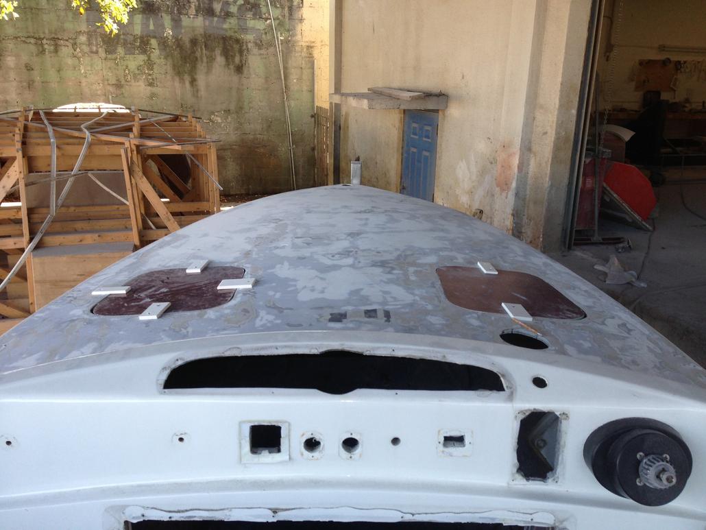

zavier24 04-02-2013 09:28 PM
1 Attachment(s)
Yup, went with closing up the hatches! I think I'm going to like it, it's going to look plain but long and sleek which is what I'm looking for. I think I might have to do some type of bow rail though.
Attachment 497358
This is where I'm at now on closing the hatches and then throwing a matte on the deck to get rid of the old cracks and all the other little things. Have work tmm but ill be back at it on thursday and friday
Attachment 497358
