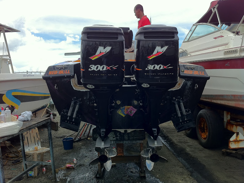

Hi, who ever tried a PP25 sportdeck with props running inwards ? One of m'y friend told me it was all good on his pp25, but i Heard say from other people that handle was very bad
This totally depends on what you are trying to achive. Spinning your props inboard will make an azz heavy boat run a tad faster, But you really feel the props jerking the rear of the boat around. The higher the X-Dim the more you feel it. A deep X-dim may not feel it at all. also (depending on your Xdim) spinning in will not carry the nose well since it lifts the azz more.

What do you call Xdimension ?
I swapped mine to inward rotation this year. It definitely lightens up the back end. Also had the props (Bravo's) labbed, added an inch of pitch and had cupping added to the tips for more bow lift. It made a big difference. Felt like a different boat. It took a little while to get used to it. I'm happy I made the change.
FYI. Handling around the docks is worse. You basically have to drive it like a single.
The Hight of the Propeller in relation to the bottom running surface.

powerplay 25, thanks for your feedback
fast donzi, that's my setting
with 28 B1, but will move to 26
