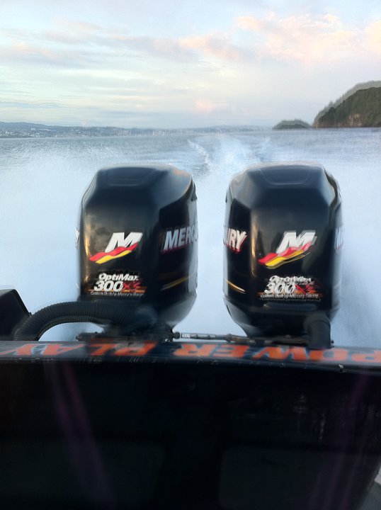

powerplay 25, how does it handle in the rough ?? water is quite rough in FWI

From: st joseph martinique f.w.i
Default my powerplay 25 and nicolas's powerplay
ludo73 is offline

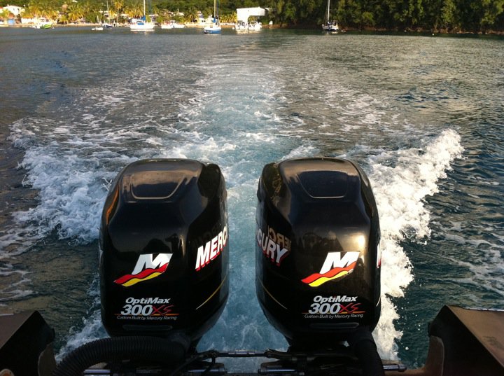

  #1824
Joined: Oct 2009
Posts: 358
ludo73 is offline
It handles rough water just fine. Just keep the motors tucked in. If the waves are large you have to back down your speed as the props will break loose.
I can assure you it is no rougher out there then it is running the Jersey coast.

  #1828
Joined: Oct 2009
Posts: 358
hmmm about 2-6ft everyday
