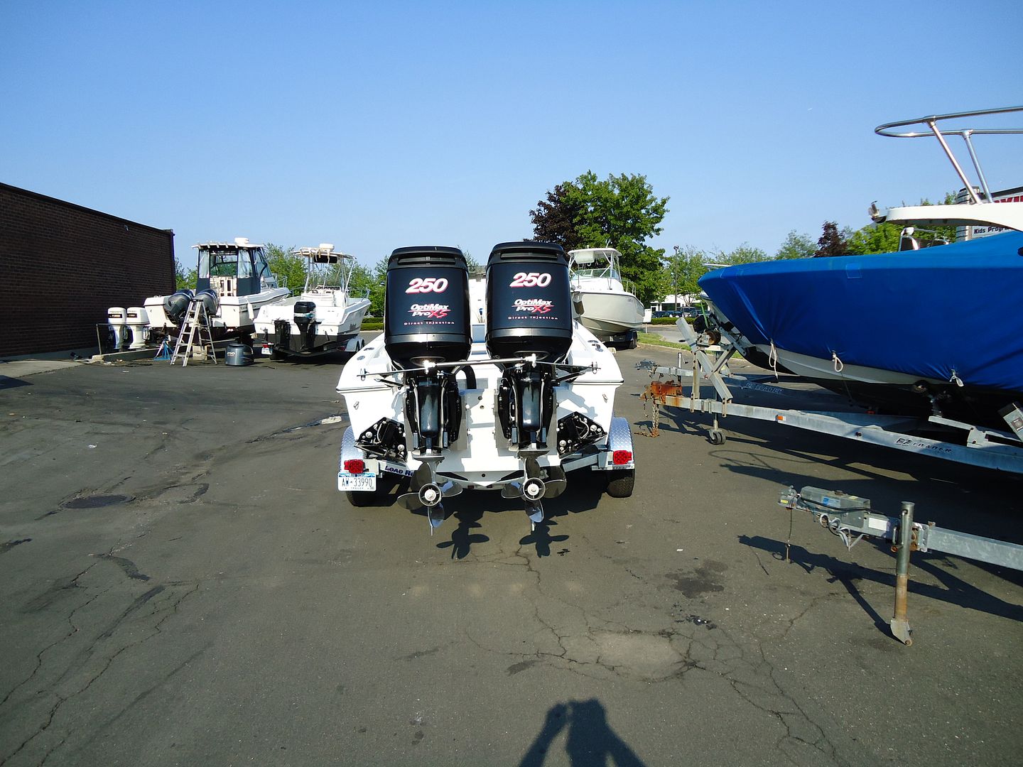

How many inches on center are your motors.....250xs can be done on about 24.5" centers but they will be CLOSE...by the looks of your motors you may not have to widen your bolt holes....

all you gotta measure is the tiebar length and you will know.....if its more than 24.5" you are good to go.....mercury reccomends 26" i think....i will check when i get to the shop tomorrow.....

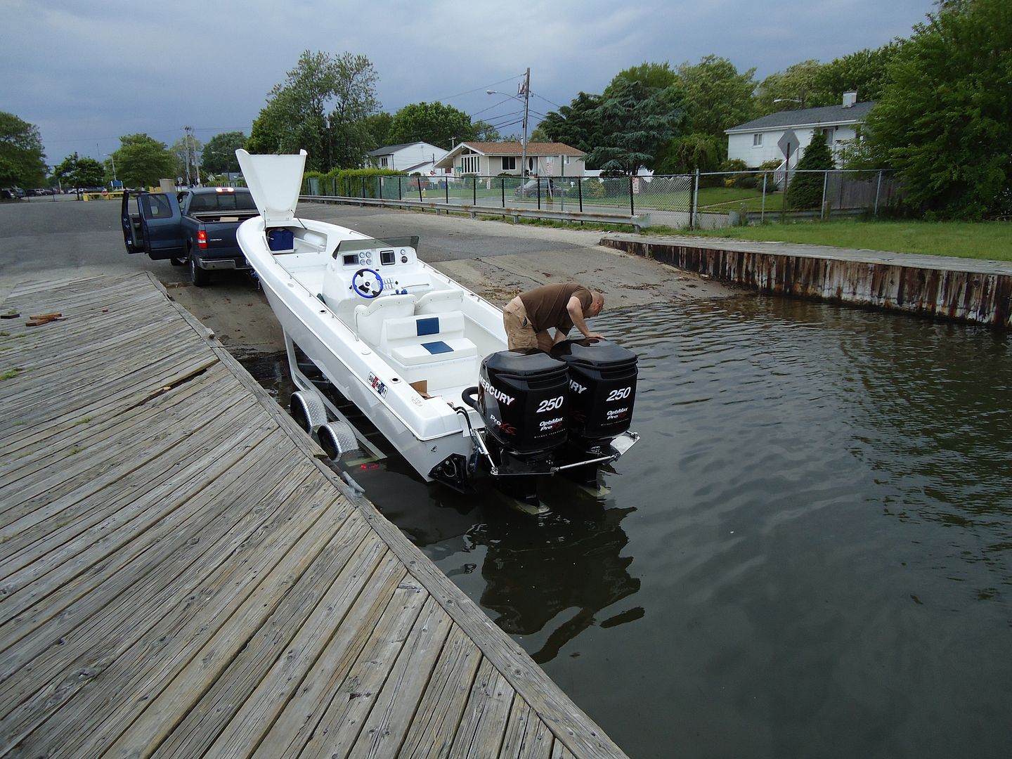

this boat is mounted 24.5" on center....they are close but not bad....only issue is if you trim one motor and not the other they will whack one another....these are 2010 250 pro XS Merc 3.0 liters

nice boat. I like cc set up and the seats.
