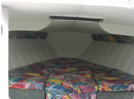

I have supports between the seat and the V berth but they dont extend as far as this picture, this is a 99 in the classifieds. wonder why they put them on some and not others.

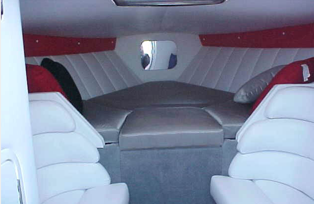

mine looks like this, I would like to add the supports, any idea if this is possible?

I would think having the bulkhead extended farther, or better yet have both sides join would increase ridgity and help get rid of some flex.I would try to get some advise from some one that specializes in structueral boat repairs. Try glass dave, or Art Offshore ginger in the fiberglass and paint section.It looks like powerquest did it that way to gain headroom.

I just went to Boat trader and took a look at all the 28 listed and everyone I looked at was just like yours with no bulkhead support. I would give a few of the other 28 owners a phone call and see if they are having the same issue. Really seems odd to me that they cut the supports out of the 28.
