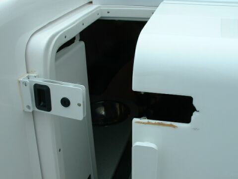

I had a problem where in rough water with the cabin door closed .....the movement (real quick) ripped the locking mechanism out of the lexan plastic. Took it back to the factory and they repaired it and then stuck a sticker on the door "Do not run boat with the cabin door closed"
They mentioned that it was a pain to do
I tried to upload a pic ot the door....but it does not want to go.
enticer is offline

I emailed the God's and asked why I couldn't upload a picture.they said the sight was down....I really didn't see that. I will try to upload the pic again

How did they fix the problem with the latch? Does your door have slider blocks or rollers?.
Mark 38 is offline
Old 07-10-2008 | 11:52 AM
Posts: 1,238
Slider blocks...which I have already had to reinstall them. The factory did the door and said it was a *****!
