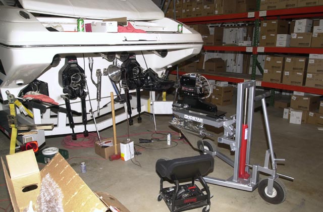

here is how close I am to putting on the drives, Just need a little time

Ray, I like the 16 pound "Drive Installation and Alignment" tool leaning up against the transom...
"This *BAM* drive *THUD* is *WHACK* gonna *BOOM* fit, dammit!"

Sad thing I had to use it to get the gimble bearing in. It only took about 4 hits!
