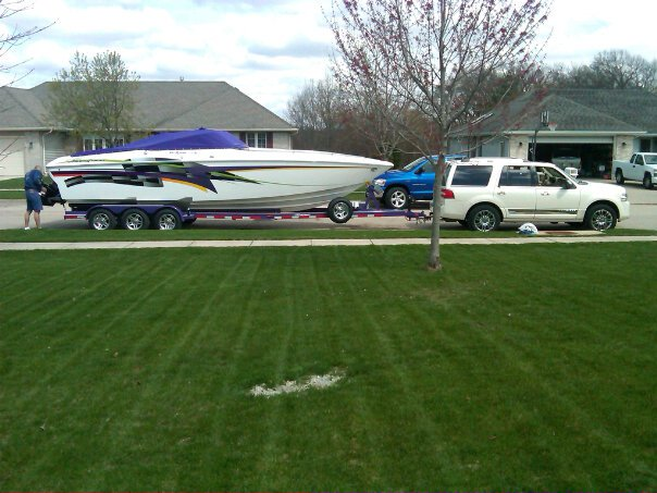

Default Pics from last Friday
Some shots from that day.
Attached Thumbnails PQ General Discussion-river1.bmp   PQ General Discussion-river2.bmp   PQ General Discussion-river3.bmp
