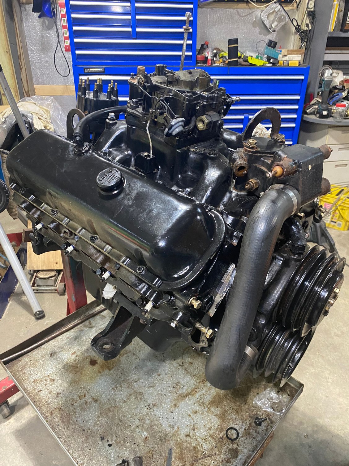

got the heads off the starboard motor and still can’t figure out why it’s only moving 180 degrees. Got a couple different options to get the motor pulled out so time will tell what the issue is.

Finally made some time to get the engine pulled and tore down. I live in Michigan so I’ve got plenty of time this winter to get it ready for spring. Next step will be to deliver to the local machine shop.

hey Kreed, been plugging away on the motor, cleaning up the internal parts and cylinder heads. It was hung up on rust from the bottom of the cylinder wall in #7. I have some time off work coming up, looking to start reassembling here in May.

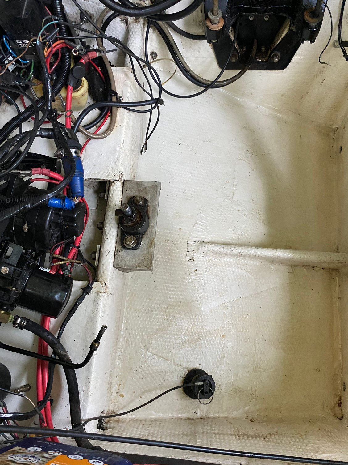

Slowly getting it back together, I really thought I would have had it done before July but everything seems to take me three times as long as it probably should. Got my son involved cleaning up the bilge.

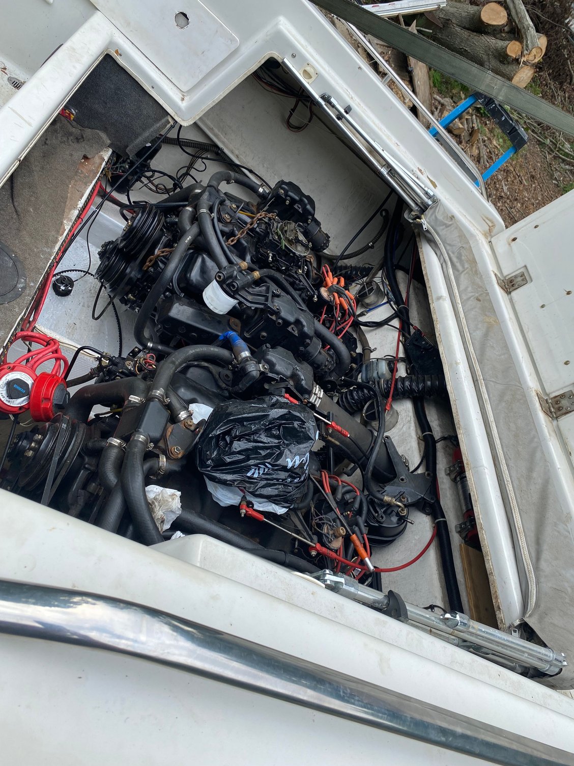

Got the motor dropped in and topped off the gas tank. Need to hook up all the electrical, accessories, exhaust and get the drives back on.

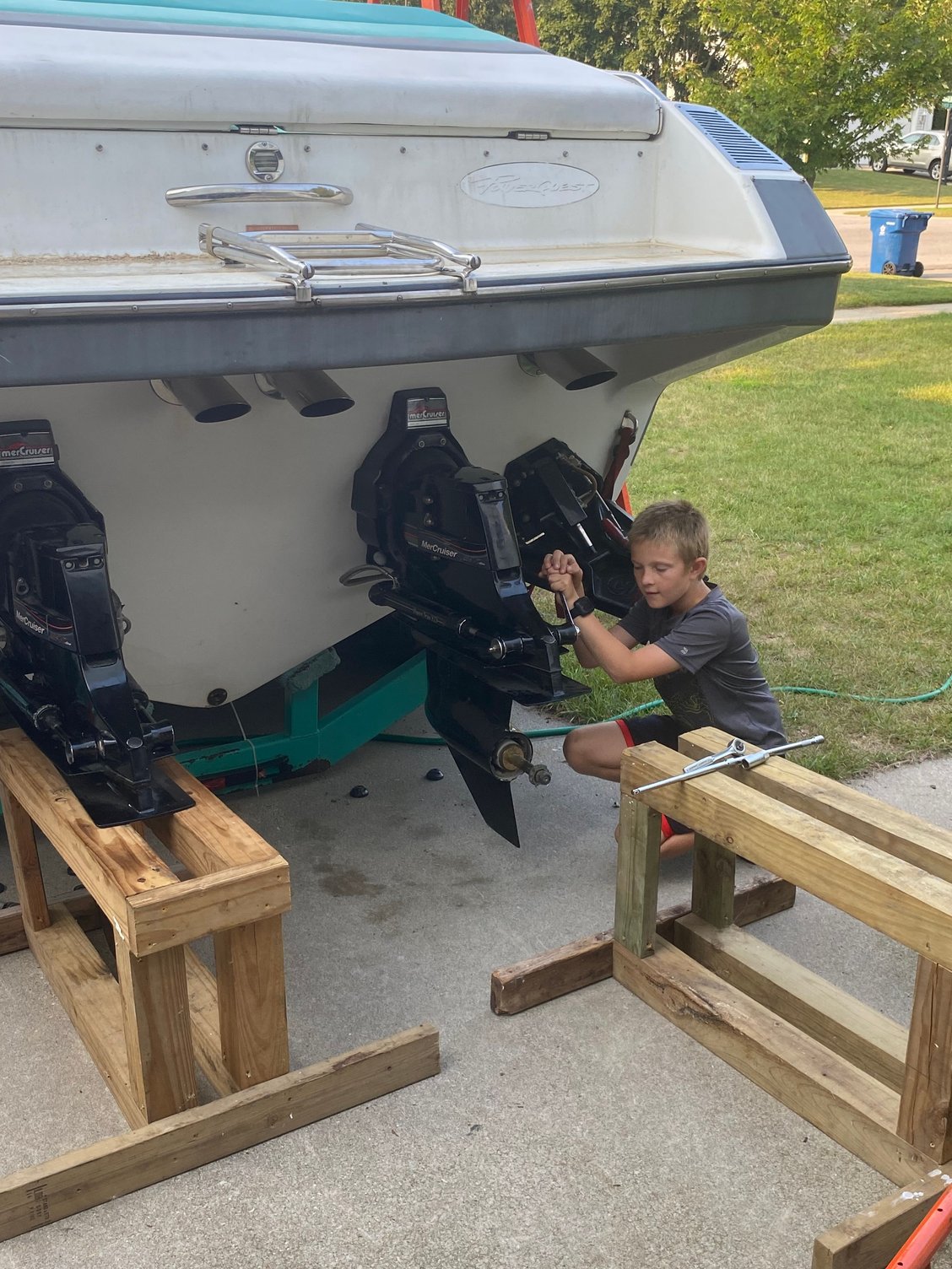

little helper got the drives on
