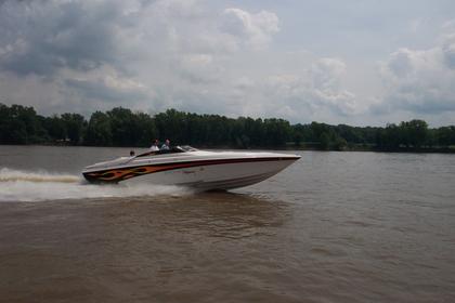

OK, here's the deal. Finally got around to replacing my Corsa mufflers with straight tips. Was out yesterday with a bud for double checking GPS speeds. I picked up 200 rpm, now right @ 5100. I running labbed 28's, can I turn 30's? (fresh water) I suspect turning 4750-4800 rpm with 30's would yield the same top speed numbers. ps. 4000 rpm = 62 mph. Here's my pace boat,
