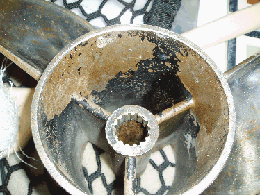

Got the Quicksilver 14359 thrust washers--they are too thick and cause the prorp to be to far out on prop shaft.
There is a taper on the prop shaft and a corresponding taper on inside of prop. Local-yokels are saying I don't need thrust washer. I don't like the feel of that but the prop seems to fit perfectly with out one.
DO I dare run it for test with out the washer? The smmes to be no interference wiht carrier or an part of prop housing--

Some of the older props didnt take a thrust washer some did.If it has the taper in the front I would say its ok. Post a pick of the front of the prop to be sure.

here are some pictures--bow end, stern end, overall. Hope you can see the taper in the bow-end picture and can judge from "ears" something about prop--supposedly an old TRS clever.

No washer needed for that prop. I myself would not use that on any application. Old school prop. Your not going to happy with it .Go to a bravo 4 blade.
