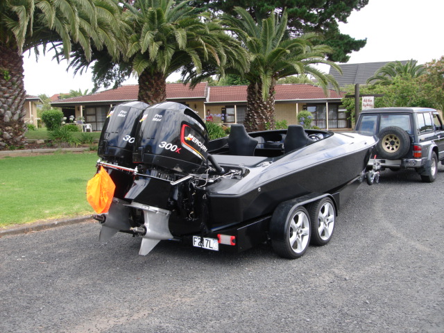

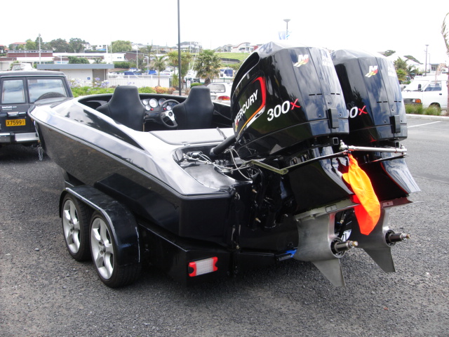

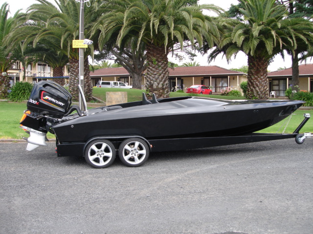

Bravo's are not popular in my part of the world to run on these types of boats, but in the hours and hours of reading I have done it seems to me it would make sense to run them in my application, the boat really needs alot of stern lift, have attached a photo of it sitting in the water to show just how stern heavy it is...
Would be interested to hear your thoughts on modifiying a set of bravos to suit.
