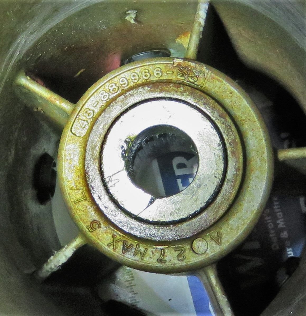

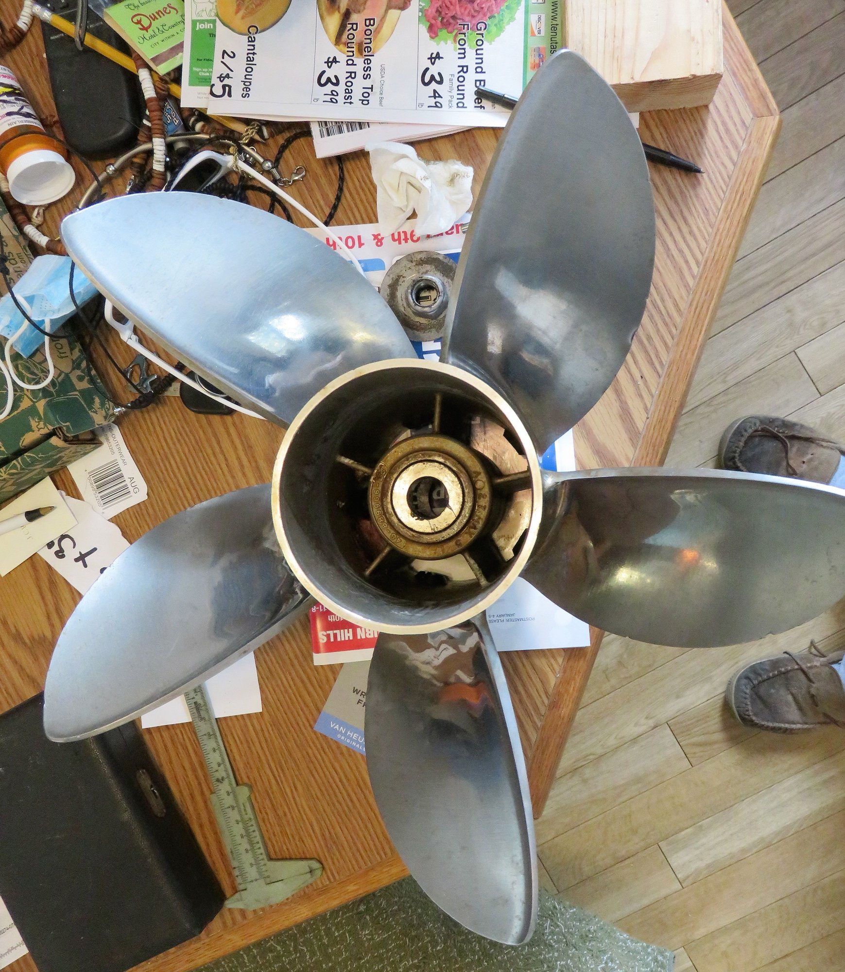

I purchased a used propeller that was supposed to be a Mercury Racing Max 5 27p. I was told that it had one small ding that I could file out but all of the blades are nicked up rather badly including a 1 1/2 millimeter size chunk gone. The part number stamped inside the prop is that of a Maximus 28p and it has been repitched to a 27 as indicated by the number in the pictures. The word Max 5 has also been stamped onto it along with 27p. The logo on the outside of the barrel does not match that of pictures of either the Max 5 or the Maximus. The thick barrel and lack of a flair or diffuser look like a Max 5. What the heck do I have here? The first pic is of a Max 5 from Teague's site. Note that the logo is different from mine but the thick, straight barrel does look like mine. The other pics are of the prop in question.

The max 5 is a cut down modified Maximus from mercury. From the picture the diameter looks big but that’s probably just the picture. This one looks like originally it left Mercury as a Maximus and was modified to max 5 specs.

Thanks. Yes there are two barrel lengths and I'm not sure which I have. This prop did come off a Donzi 22 from a reliable source who did inform me that the blades had some nicks but that one nick is pretty deep. He said it worked better than any other prop on his 540 22 Classic but he changed to a higher pitch when he upped the power. He has offered to take it back if I can't use it so that is not the issue here. I just thought it was odd that the casting numbers are that of a Maximus but maybe Mercury used a modified casting mold? I do plan to test it on my 525 powered 22 Classic when the lakes again become liquid. If I like the performance then it will go to BBlades after I get some baseline numbers and I will have him clean it up and possibly repitch it to a 28 which I expect that I will need. Is that nick a problem? Does that mean that each blade has to be cut down that far?

I suppose that is possible but the logo cast in the side and the thickness of the rear of the barrel suggest otherwise. It's a mystery! Where is Brett? lol

I purchased a new Max 5 from Teague almost 2 years ago now. Here is a picture of the hub. It looks like yours with the maximus pitch XX out as Mercury starts with a maximus and modifies it.

That is exactly what i needed to see and to know! Thank you very much! Are you happy with the performance?
